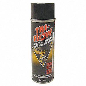

« Reply #7 on: May 11, 2018, 05:09:40 AM »
I read about not lubing them when I first got my bike. So I ordered a new set. I lubed
the old ones in the meantime. They're still on there. WD40 would probably work great
for a while, but "wear out" pretty quick. I put TriFlow in mine, stuff I learned about when
mountain bike riding...
