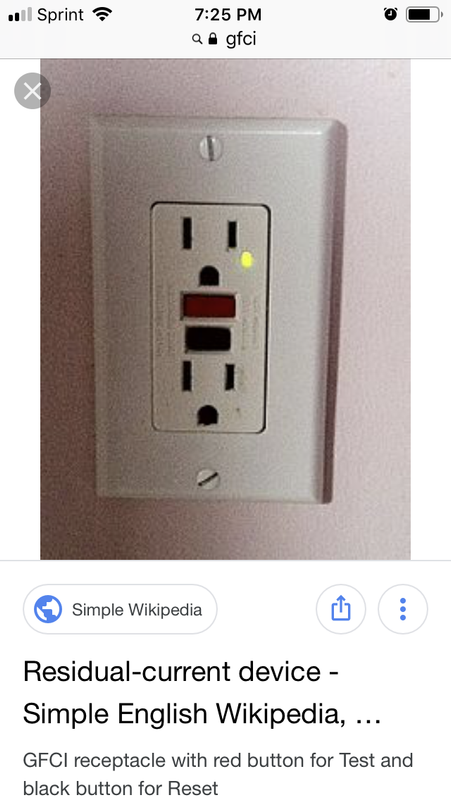

And im thinking you have some gfis someplace? ?
 prob garage kitchen and bathroom . . .

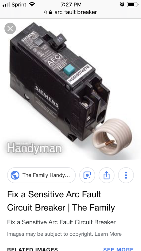

Any of your breakers similar to this ? ? ? With the little test button ? ?

One gfci in a down stairs bathroom could run all recetacles in all other bathrroms . .
And one behind the fridge or something could run others in the kitchen .  .

Breakers do not have have test buttons.

No Gfci anywhere.

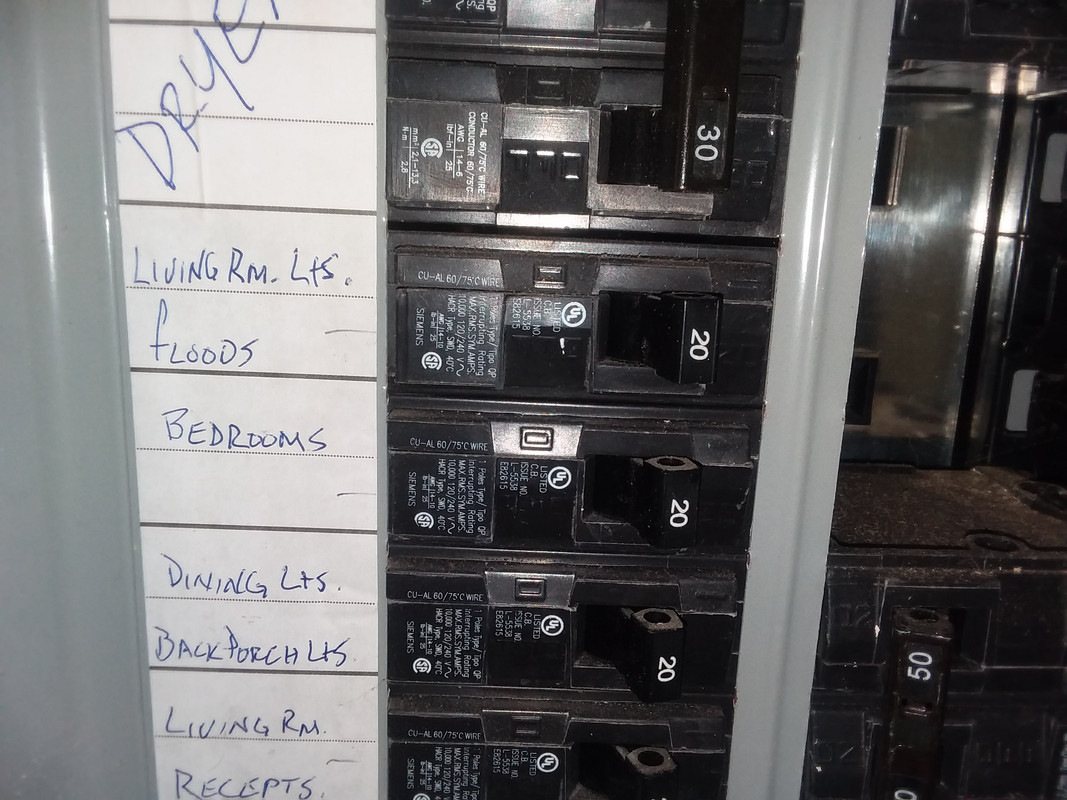

There is a picture of his breaker panel here.
https://postimg.cc/68Bx7GDF
Britman- are the loads you identified
Bedrooms 2 and 3. No ceiling light, fan or receptacles working.
Living, dining room no lights of fans working but receptacles do.
No outside lights by the 2 doors work. No porch light.
The same as the loads identified on the panel as
Dinning Lights, Back Porch
Bedroom
Living Room Light/Floods?

Picture of the breaker panel
Britman says he believes the loads that don't have power are on the left hand side of the panel, the ones below the generator input breaker.
I was trying to think of a logical reason these three breakers/loads would be affected by something having to do with the input breakers setting.
As memory serves, and its sort of backed up by the breaker panel layout, the breakers are connected to the two phases coming in in an alternating sequence.  If one phase were improperly connected the three loads down below the input breakers would not be all out (i.e. no power being supplied) just one or two, in an alternating sequence.  So, I guess I don't have a clue right now as to what, if any, common cause such as loss of one phase, might be at play here.

« Reply #131 on: December 12, 2018, 06:22:03 AM »
This is the regular panel. It's the 3 in the middle.

local guy was just here.
Took the cover off both panels.
The  breakers that "didn't work" on the house panel weren't connected to anything.  Grin
The corresponding breakers on the fuse panel were off. Turned them on and Hey Presto let there be light.
He told me it was done that way to avoid fitting an expensive transfer switch and was to code.
He kindly only charged me a token fee as he does work for a couple of builders I've got to know locally.

Posts: 13177
« Reply #141 on: December 22, 2018, 06:11:46 AM »
I think I finally see what you said.
The generator panel was added on after the main panel was in service.
To provide power to a selected group of items from the generator, those items were disconnected from the main panel and added to the generator panel.
Then, power from the main source was connected to the generator panel and interlocked with the input from the generator.
That way, a selected group of items could be powered from the generator without having to do much switching and no questions about the possibility of "cross feeding" the main circuit from the generator circuit.
An interesting approach.  And thanks for keeping us informed.  Knowledge is power and we all know more thanks to your feedback.
