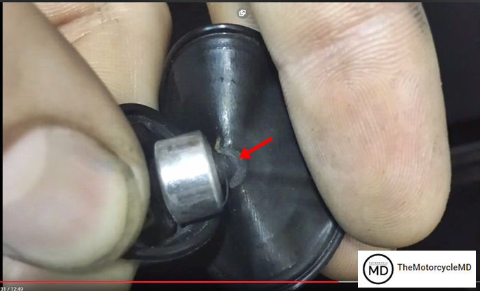

« Reply #10 on: May 29, 2018, 11:10:54 AM »
I'm still puzzled about what caused the early failure of the second Tourer's diaphragm.
My '07 Shadow 600 had a factory recall issued on that diaphragm a few years after I bought the bike new. The recall covered '08 too or something like that. It was replaced free. I assumed the dealership replaced it with a new and improved version. I *assumed* becuz the second diaphragm gave out last year and left me stranded on the freeway. Anyways, probably the factory received a bad batch from the diaphragm supplier.
Incidentally, TheMotorcycleMD on YouTube mentioned that the rubber behind the larger diaphragm may deteriorate exposing the mesh where upon it won't hold vacuum. I would think the same area could be damaged if you pulled too hard on the diaphragm while double-checking that the button was fully seated in the metal dowel.
