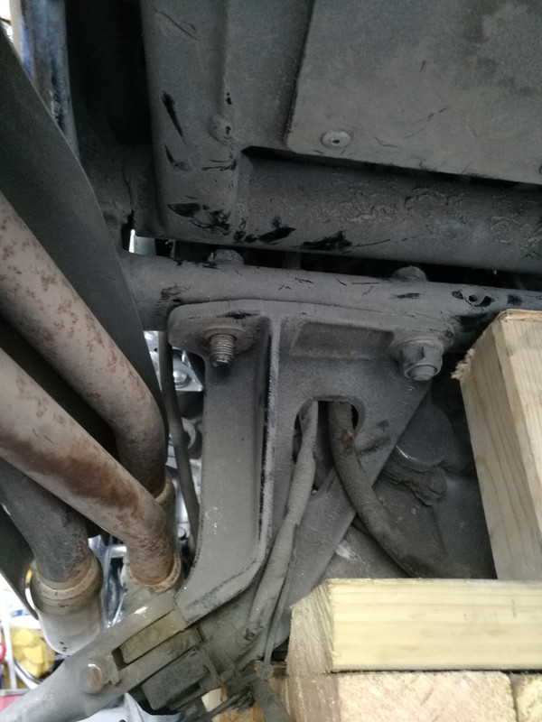

Please see photo.
Somehow I lost one nut on the side stand.
Doesn anybody know what dimmenson is the nut that is missing?
(I could take the other out and measure, but then the whole side stand is loose.)
If I should choose to replace the bolt also, is that easy?
It seems like very tight to get it out?

Go to Partzilla website and find that bolt. Often the size and thread pitch is stated in the bolt description.
Posts: 15374
« Reply #2 on: May 27, 2018, 08:07:11 AM »
The bolt is a 12mm x 50mm long, doesn't give the pitch. If you have a metric tap/die set you can use the thread tool to determine the pitch.

Pull the other nut off and match the threads at hardware store or lift bolt out the top.

12mm x 1.25 x 50mm long.

 NO... Honda and most metric lug nuts are 1.50 not 1.25

Go to honda and order this or order it online .
NUT, FLANGE (12MM) (FUSE RASHI)
90306-KF0-003
$2.74

I found a nut today at a car work shop that fitted well.
12 mm - 1,25 treads
(Valk, standard, 2001, european model)
