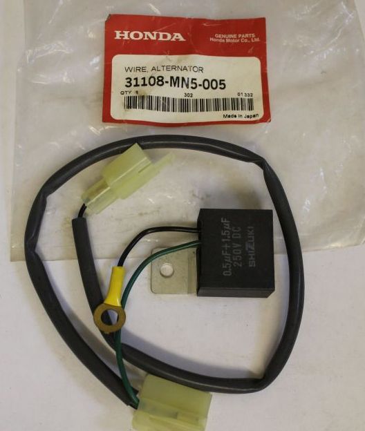

rockbobmel
#26
Welp it's in.  I picked it up at the UPS hub at 7 this morning and had it done by 8:30. I was able to "clock " it like described. It got stuck because of the diode, capacitor? thingy on the end. There wasn't one on the old one so I took it off.  I got scared because I tried to start it before I had it back together, and it didn't start.  I almost walked away but remembered that there was the tilt sensor flopping around. I held it upright and she started.  I crossed my fingers and rode upstate Vermont.  All is well!!
Another plus is that it's a Hitachi "made in Japan ".  Yaaaayyyyy!

dalai-lama
I replaced mine two weeks ago at 142K miles.  The lead for that is a bit shorter on the "goldwing" and my original one had a wire that was starting to be frayed so I wanted to use the new one.
I was able to mount that in a different spot on the alternator where it would reach but then this got in the way on getting the alternator back in so I just let if flop and then once the alternator was back in, I was able to secure back into its new position on the back of the alternator.

rockbobmel
I hope it's not necessary because the old alternator did not have one so I took it off the new one.

Quote from: rockbobmel on Mon 11, Jun 2018, 10:38:59
I rode 500+ miles this weekend.
It's a filter for IS stereo, not necessary on other models.
