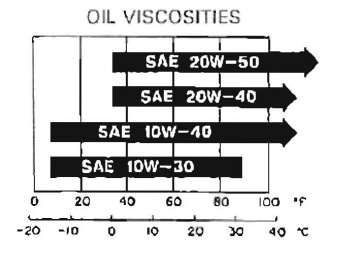

Viscosity from Valkyrie manual:
According to the manual, 10W30 shouldn't be used above  roughly 88°F.  A better choice, especially in a hot climate, is 10W40 or higher.  I use Mobil1 15W50, even though we don't get Texas temperatures in Alberta.
