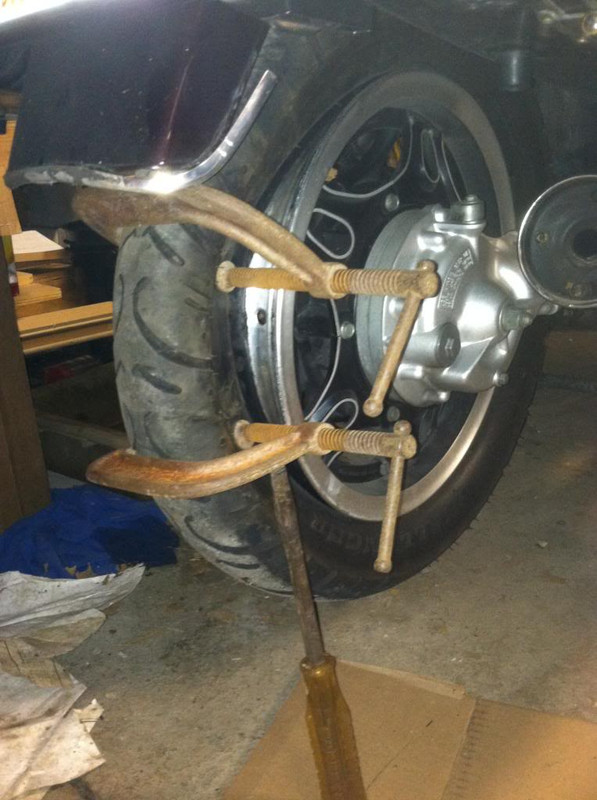

You must break the bead on the tire to replace the stem. If you have one or two large c-clamps you can do this without removing the tire. Shown below is my old SilverWing, but the concept is the same.
