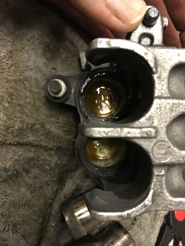

« Reply #8 on: June 25, 2018, 05:20:06 PM »
One thing commonly ignored that can make a huge difference in rear braking is disassembling, thoroughly cleaning, then lubing while reassembling the brake pedal and its pivot.  If it's been years since it's last been done, you might be surprised how powerful the rear brakes can be, certainly enough to lock the wheel with firm pressure.
This and prob new seals and or bushings really make a difference  .( Rebuild )
Sure gave me more stopping power. . .
photo upload
« Last Edit: June 25, 2018, 05:30:51 PM by bill-jr » Logged

« Reply #9 on: June 26, 2018, 09:37:57 PM »
You're right, I check the seals whenever I change the rear tire.  I have seals and pistons in my parts box.    Sometimes the pistons are stuck and need to be freed.
