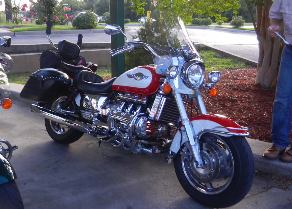

« Reply #8 on: July 05, 2018, 09:19:38 AM »
This bike has Progressive front springs and OEM Interstate shocks.  I think the geometry looks just fine.  cooldude
