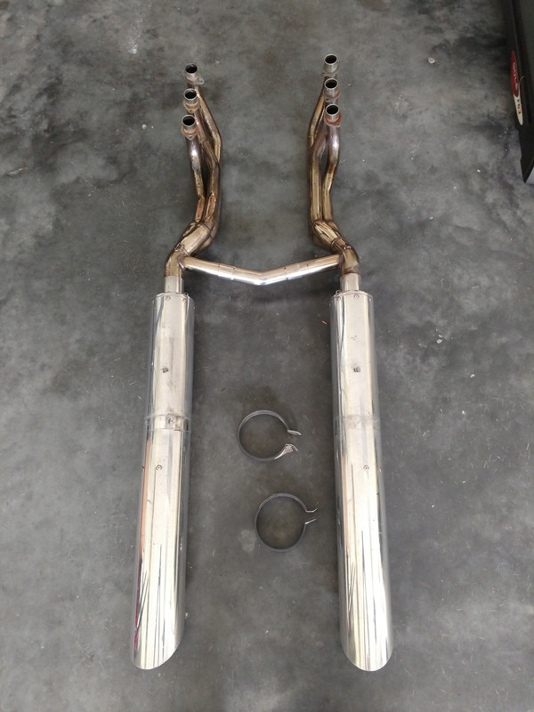

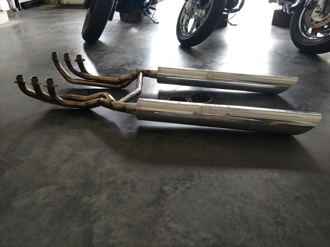

I recently came into a Two Brothers 6 into 2 exhaust system with the cross over, the one with the round canisters and slash cut ends.
Unfortunately they did not include any mounting brackets, only two big clamps with a rubber seal, I have searched the web for pics or mounting instructions and cannot find any that will show brackets.
Looks like there are some springs missing also.
Anyone out there that would be able to help out with pics of mounting brackets/ mounting points / measurements, any info would be helpful so I can get an idea of how and where they mount.
Maybe I can have some brackets fabricated.
Can pm phone number if it makes it easier to send pics
Thank you  cooldude cooldude

Edit: Now seeing your pics, it seems likely that if those came off a Valk, the two rear mount bracket-hoops left marks on the cans where they went.  A good guess would be they went to the Valk rear exhaust hangers (at the rear foot peg location).
Also, that crossover may not go good with a center stand or belly tank or maybe even one of those permanent (or temporary) jack adapters.  Just guessing, but food for thought.

Thanks Jess
I figured that the crossover would probably be no good with the belly tank/center stand/ adapter.
I bet that the person that removed the exhaust did not know any better and left the mounts on the hangers just like you said.
Seems to me that those round clamps go where those marks show on the canisters and I am guessing that they also work in conjunction with the mounting brackets.
I will try to call the manufacturer on Monday and see if I get anywhere.
I figured someone here might have the same exhaust and might be able to send me a couple of pics of the mounts.
Thanks again  cooldude cooldude

Jess
Yes, some BIG CANS there, 4 1/2" and it looks like they would extend all the way to the length of the bags.
No immediate plans for them, If and when I mount them it most likely will be on a bag less Valk.

I don't have a set of those pipes, but it looks like the brackets go around the cans and mount to the OEM bracket that the OEM pipes attach to.
Mounted just like the OEM pipes, at the headers and at the passenger footpeg bracket.
Posts: 16795
« Reply #8 on: July 06, 2018, 06:47:56 PM »
I had TBR canisters on my first Interstate.  It is as Hook says.  The clamps simply connect where the OEM pipes would be hung.

« Reply #13 on: July 06, 2018, 08:40:12 PM »
Nice bike Willow.
Thanks for the info
YES, that is what I was looking for and that would mean that I don't need any brackets  cooldude
