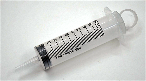

Another option is to reverse feed gas into the carb bowls through the drain spout with a large plastic syringe using a high dose of B-12, Stabil. The jets sit submerged in the solution. Rinse and repeat daily, so on. Little faster that way.

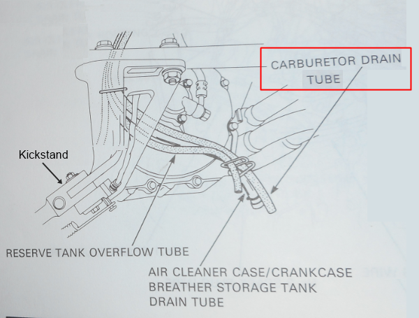

  Ron,
  Is there a common drain for all carbs,(where is it located,left or rt. bank ,front or back) or is there a separate drain for each carb .

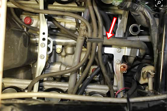

« Reply #23 on: July 11, 2018, 08:15:35 AM »
It's these 6 tubes that goes into a single large tube (red arrow) that exits at the bottom of the bike next to the coolant overflow tube & the breather crankcase tube (2nd pic). The six carbs then drain collectively at the bottom of the bike for your convenience. However, if the 6 tubes where they're connected to the individual drain spouts on the carb bowls are creased, gasoline instead is gonna drain on the top of the engine. When you clean under the carbs, the drain tubes gets bumped around and rubber tubes splits at the drain spout connection. I got rid of my drain tubes. If the previous owner did that too, you won't have them. The drain spouts can be accessed individual easily from the side of the bike. A slotted screw opens & closes the drain spouts (bottom pic) and the drain spouts themselves are nearby, with tubes on them, or without the tubes. [edit] Yes, each carb bowl has its own drain spout & tube.

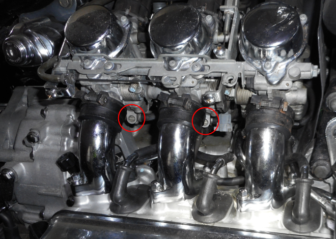

Planning on doing the reverse injection . Just wondering if when I open the drain screws if there is a chance the seals will leak when I crack them open to inject and then close to re seal ?

« Reply #28 on: July 13, 2018, 11:53:04 AM »
I believe the drain screws have a metal-to-metal seat, so don't over tighten. Perhaps, hash mark the slot position as a reference. Also, the carb bowls have overflow/vent tubes.
