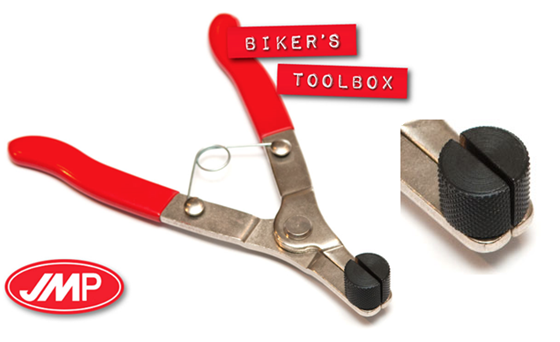

I insert a paint stick between the old brake pads. I prefer to not let the pistons stick any further out of their bores, though I'm not 100% if it's a legit issue.
Thinking about gettin this tool that rotates the pistons.
