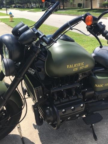

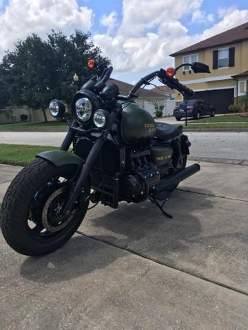

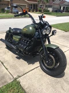

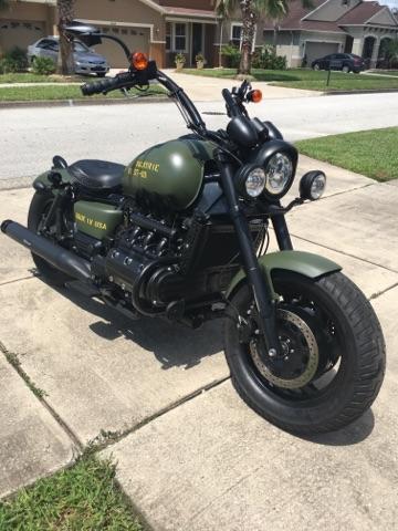

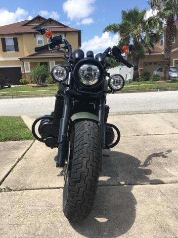

Here she is boys and girls...................
Larue's new project all finished, ready to roll and turn some heads  cooldude cooldude
Another awesome ride addition to the Florida gang.
I posted on Larue's behalf, ask away and I am sure he will be glad to answer any questions or sign any autographs  Grin

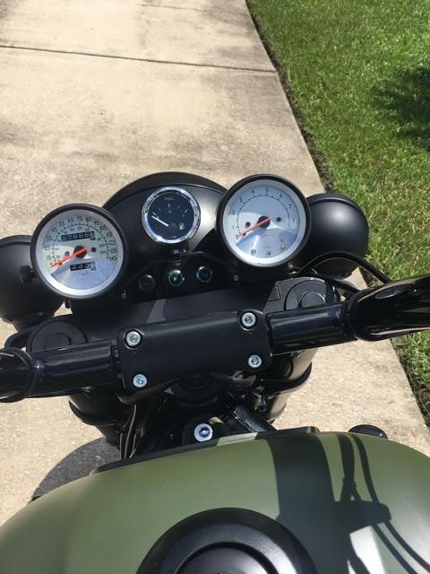

Spot on.   cooldude   I love the slash intake and humm a gas gauge - talk to me.

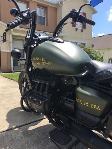

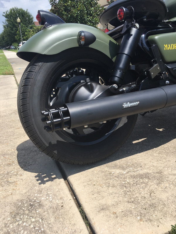

« Reply #4 on: July 25, 2018, 03:09:17 AM »
Thanks guys and thank you jack for posting. Just a little history here, this bike started as an interstate therefore the wiring harness was replaced with a standard Valkyrie one, that involves adding standard gauges , triple tree, speedo hub kick stand switch etc...had a man in Orlando  fabricate the  seat components to fit on fame, also he welded brackets on frame  to fit the aftermarket rear fender on and also welded the Tail gunner  stacks to about 3" ( these are complete stacks with glass pack and rotating tips) of the OEM pipes where they connect with the headers section and had it all ceramic coated. He also did  the paint job. Got all chrome parts powder coated  and plastic ones painted then took it all to  Bill aka grumpy to install the Valk standard wiring harness as it's completely different from the I/S one. Bill did the rest of the wiring and gauges etc making sure all is functioning as it should and painted the engine block back. thank you bill for the great work. The seat is of a Harley crossbones fitted nicely into a pan that hugs the frame and attaches to it, jack hooked me up with a source on eBay for the rear fender thanks jack, rear turns are V rod, front are some Harley that I wanted them on handlebar, day maker lighting in front, tail gunner pipes rotate on throttle  and sound awesome. Enjoy

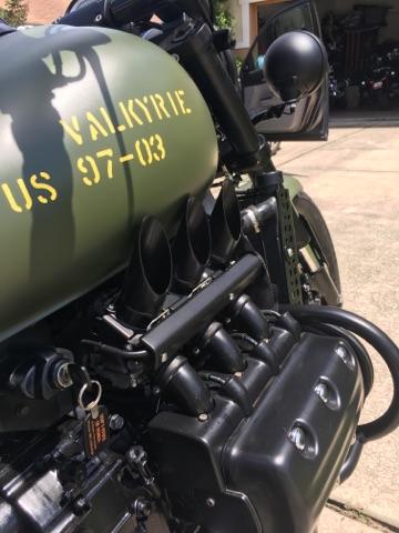

Quote from: jetmech1 link=topic=10237
Is the whole engine powder coated or just paint?
[/quote
All chrome on the engine was powdercoatoted. The engine itself is spray painted with high temp engine paint.
