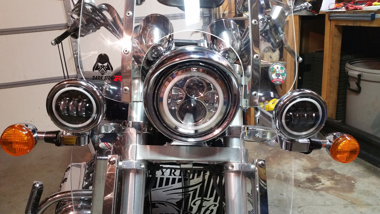

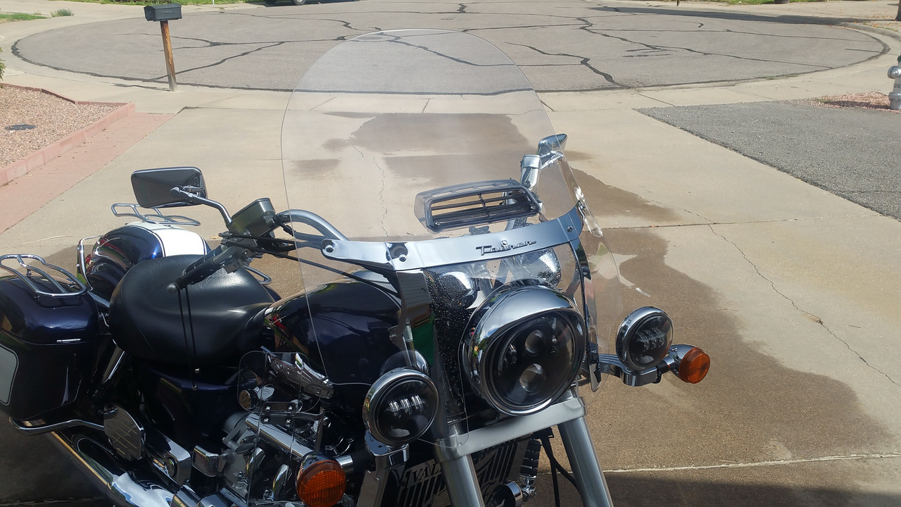

« Reply #19 on: September 26, 2018, 02:35:59 PM »
darksider, it is one of the national cycles two-up windshields, but i actually cut it down to the right height for just me @ 5'10". So now it is 14" H x 24.5" W. It was mainly your post that convinced me to get the rifle lowers and I like them a lot. In some situations I can tell a difference but at other times my beard is getting blown straight out, but not as much up in my mouth...which is an improvement. I will mess around wit the angle a bit, an I do have the highway pegs.
If your windshield mounts have adjustment slots try to angle the windshield back a bit. This will do 2 things;
1st - it will open up a small gap above the headlight which will let in a small amount of air. That small amount of air does an amazing job at stabilizing air in the cockpit.
 - See in this picture the gap above the headlight? This really helped on my bike.
2nd - by angling the windshield back it allows air to travel over the windshield more smoothly. You want to eliminate the "Flat Brick" effect as much as you can.
 - See in the picture how angled back the windshield it? This also helped.
I had a Memphis Shades Windshield in the picture above. I had actually filed slots in my mounts to be able to adjust the windshield back like that.
I now have a Tourer Mount, with a Clearview Shield and Vent. Heaven.

« Reply #29 on: October 01, 2018, 05:12:35 AM »
Darksider, I like the shield in your pics a lot, may try to got one. Previously my shield was practically touching the headlight. I have moved it up about half an inch. I think with that and the Rifle lowers the buffeting is gone. I noticed on the pick with the clearview it appears your lowers have been removed, did you feel they were no longer necessary with the clearview shield?
Thanks all
That picture was taken after doing some work to the bike where I had removed some parts. I am still running my Rifle Lowers.
I had ridden 600 miles back from Tulsa, OK. without the lowers. I immediately put them back on. I just got back from a trip to Houston (900 miles each way), and love the lowers.
Keep playing with things. The angle of the lowers will make a difference. And keep you feet off the highway pegs when testing.
