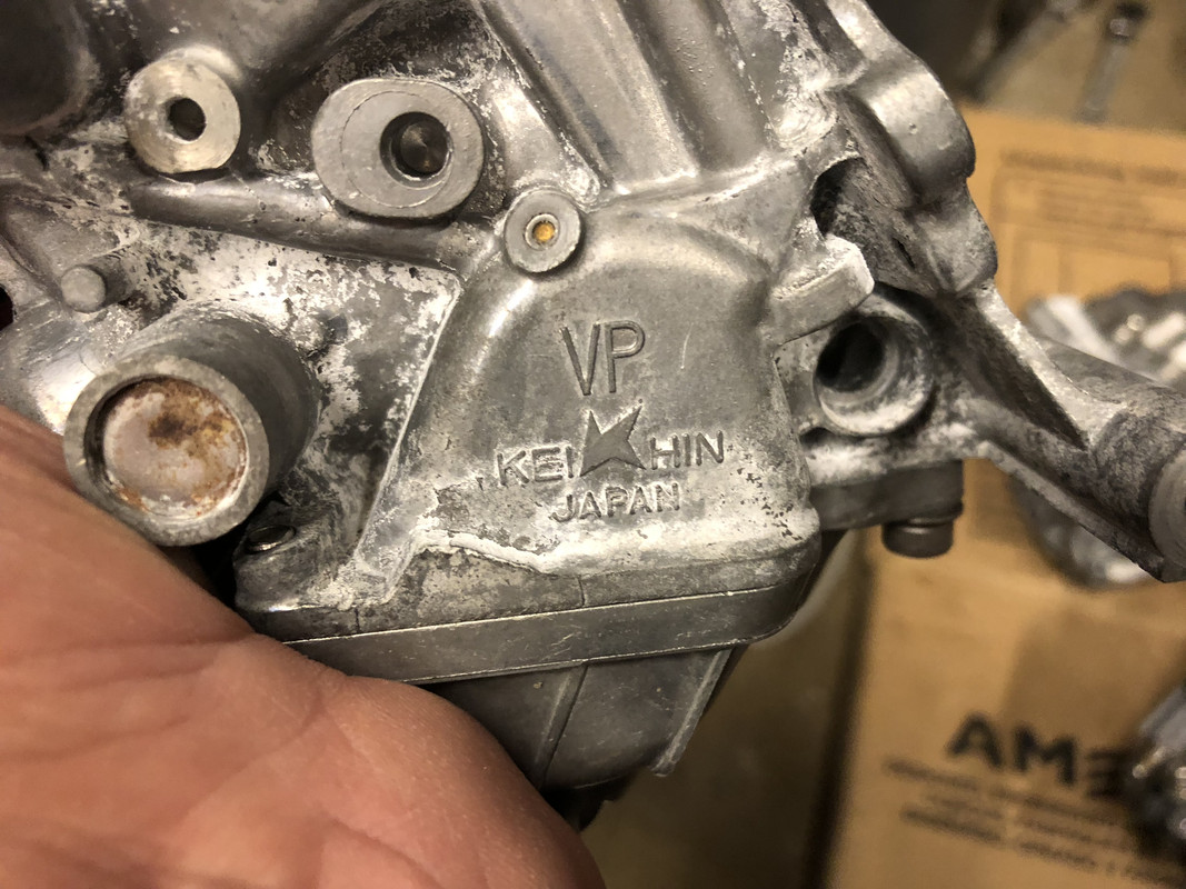

« Reply #22 on: October 15, 2018, 01:39:51 PM »
Here’s a pic of one of the carb bodies after I ran it through an additional 3 minutes per side in plain water to clear off some of the corrosion. Believe it or not, this is an improvement. I already had assembled the bottom when I took this pic. I didn't run the covers through the ultrasonic. They cleaned up fine with carb cleaner. As far as the temp, I’m not sure, but I started out with room temperature cleaner and it heated with the heat function as it worked. They all looked the same regardless of the temperature of the solution.
« Last Edit: October 15, 2018, 01:48:30 PM by Forge » Logged

« Reply #23 on: October 15, 2018, 02:33:50 PM »
Hey Forge I'm wondering if the HF cleaner is deep enough to completely submerge the carb bodies or is part exposed to the air when  working.... Is that what you meant when you said "just over 9 minutes per side with heat."?
Did you rinse them when they were removed from the cleaner?
Man, you must have freaked when you saw what happened.
« Last Edit: October 15, 2018, 02:36:26 PM by pancho » Logged
« Reply #24 on: October 15, 2018, 02:52:54 PM »
Yeah I would say those look like poop. Sorry for your troubles.

« Reply #25 on: October 15, 2018, 04:30:03 PM »
Correct, the HF cleaner isn’t deep enough to do the whole body, so you have to turn it over and do the other side.
After removing the bodies, I immediately rinsed them off and blasted out every port with the nozzle on my water hose. Then I blew them out with air until dry. The corrosion was already there and formed in the tank.
Yes, I was a little freaked. I was concerned that if the internal passages were corroded and blocked, the carbs would never work right. As described above, I blasted the pilot passages thoroughly. The carbs llook like poop, but my consolation is that they run better and cleaner than the bike ever has since I’ve owned her.
Since many have done the same process numerous times, using the same cleaner in the same way, the only thing I can think of is that there must be some difference in some carb’s metallurgy. I can’t think of anything else.
« Last Edit: October 15, 2018, 04:33:55 PM by Forge » Logged

« Reply #26 on: October 16, 2018, 02:38:16 PM »
I was sorta thinking it might be because some of the body was exposed to oxygen for nine minutes while wet with the krud kutter and the machine was on???  I don't know if attic rats machine is deep enough to completely submerge the carbs to make that a possibility or rule it out?
" I was concerned that if the internal passages were corroded and blocked, the carbs would never work right"
That would have been my first thought also..... glad to hear they are working good even though you are reminded every time you look at them.

« Reply #27 on: October 16, 2018, 07:37:49 PM »
No on the because of being exposed to air. The majority of the carb bodies (maybe 80% plus) were always covered and submerged in the fluid the whole time. The fluid came up way past halfway on the carb and the parts that were always submerged still had the corrosion.

« Reply #28 on: October 17, 2018, 04:53:57 AM »
Hmmm,,  well that leaves me perplexed.  I would not think that your idea of alloy differences in the manufacture would be likely as Keihin surely has specs that must be adhered to.... of course I could be wrong.
My next thought would be contamination of your carburetors with some substance that reacted with the krud kutter. ???
What gets to me is one person does this successfully, while you and Toovalks have bad outcomes that I don't what to repeat.

« Reply #29 on: October 17, 2018, 06:31:17 AM »
I had run Berryman’s through the carbs to try and clean them out before cleaning, but surely many others have used carb cleaners before their carbs were sonic’d because the carb cleaner didn’t work. Even then, I had run straight gasoline after the cleaner to water any cleaner down knowing I was going to pull my carbs to lessen the chance of any drips damaging my paint. The carbs should have either been flushed with the straight fuel or at least the Berryman’s was very watered down.
pancho
Posts: 2113
Bonanza Arkansas
« Reply #30 on: October 17, 2018, 06:45:09 AM »
I was thinking more like road salt or sea spray on the externals, which neither will happen in San Antonio.
Maybe something the bike is washed with?  I just have a problem with these "mystery's" that have such dire consequences.

« Reply #32 on: October 18, 2018, 12:05:35 AM »
Hi Forge!
Yep, that's a cruddy-looking carb in the photo!
But... how to clean it?
Glass bead blasting should clean up the outside, get into all the nooks and crannies, and leave them looking nice.
I have used glass beads.... I think #8.... cleaning carb bodies and it leaves a nice clean, matte surface.
But.... I used it on disassembled dirt-bike carbs where the cable pulls the slide.... no throttle shaft for the glass bead grit to get into the joint at the shaft bushings and cause problems.
On the Valk carbs you could mask off all the openings, but there is still the issue of the glass bead media getting in & around the bushings at the throttle shafts.
Maybe 'soda blasting' followed by a water rinse would work. The baking soda media should dissolve with water.
https://www.harborfreight.com/50-lbs-medium-grade-armex-soda-blast-media-65929.html
Anyone have experience with soda blasting?
Tell us about it!
In the meantime..... if it's running good and the weather's decent.... go riding!

Pancho they were straight out of the ultrasonic when they looked new. Ask anyone who has had Bob work on theirs and see if there is a different answer. I don't think so. Dont know what is going on with the ones here. All I can say is mine were perfect.

Hey Bighead,,   I'm not questioning the quality of the work that comes out of attic rats shop, I have been seeing people sing his praises for years after some of his work.....  just was trying to get to the bottom of this before I used any specific cleaner on my carburetors.  I do wonder if ANY of the Valkyrie carbs he has done ever turned out like  the ones shown here.
