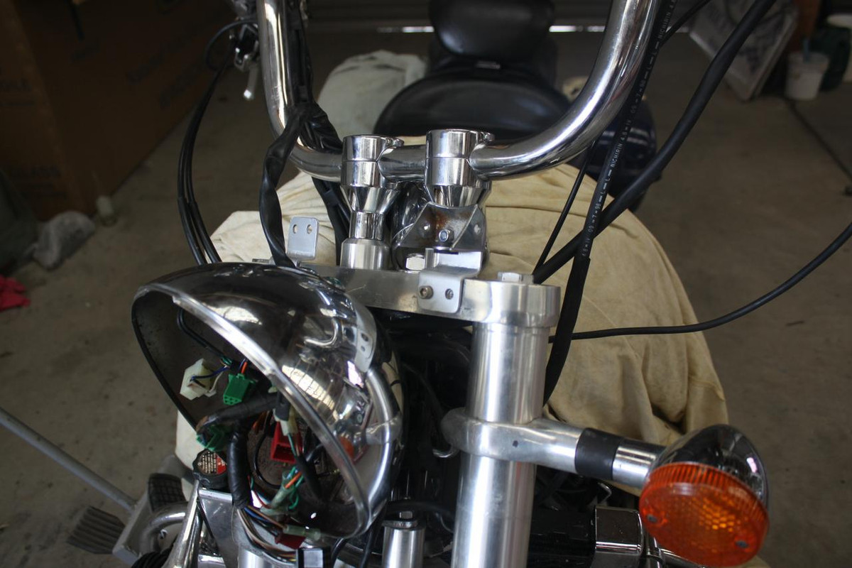

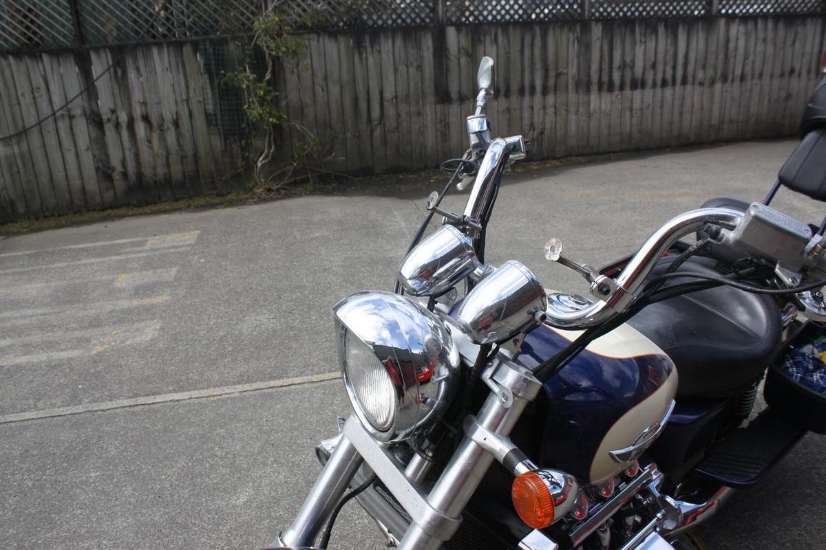

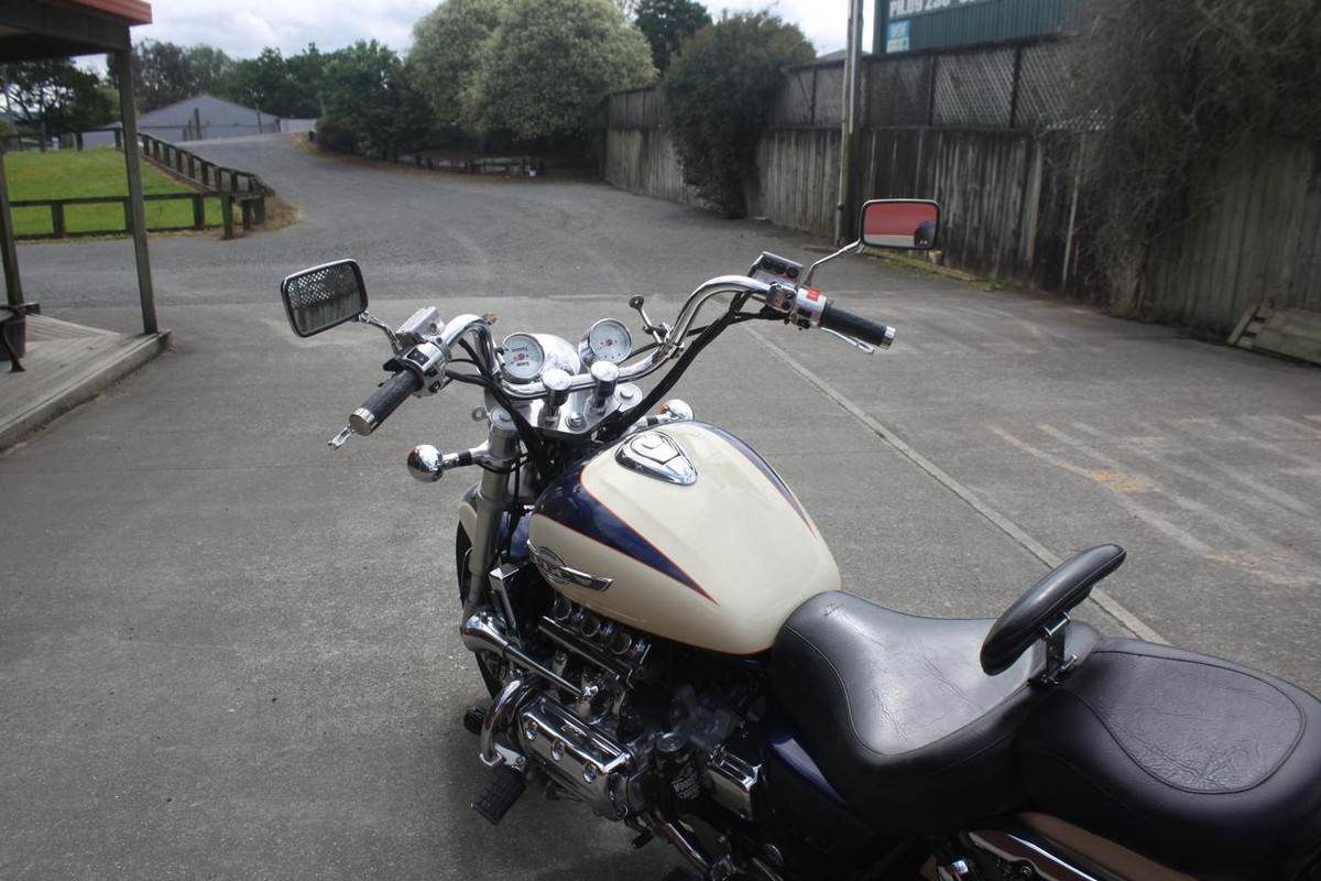

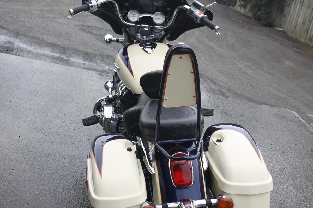

I fitted some 10" mini apes a long way back and they were a step up from factory bars for me, so easy to counter steer, no longer like pushing a wheelbarrow Cheesy

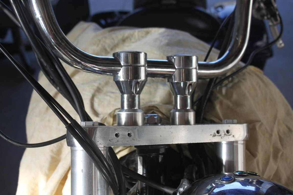

 But after changing the seat they were a little far away, especially while on the highway pegs so I wanted to lift them and roll them back..... No worries, lathe some spacers, sweet but now the recently fitted batwing doesn't protect the hands so I lifted that......then I had to lift the light to close the gap..... then I had to lift the gauges...then the wires/hoses were a little tight so unplug those and remove the crossover sections and they are long enough....just

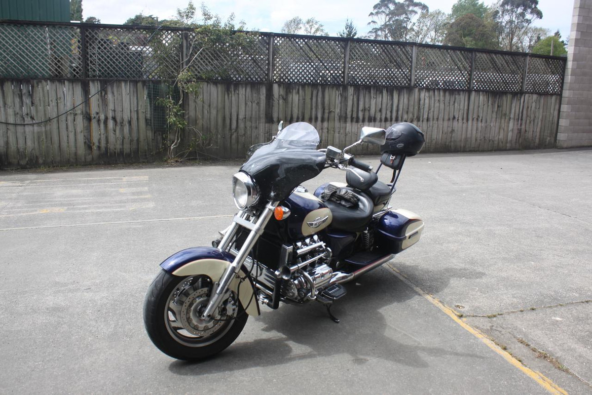

 I made a new screen and with the batwng lifted and the new screen buffeting is now less of an issue even with the lower deflectors removed..... its almost not happening so with some tweaking I should be buffet free at all speeds (has a little over 70mph ATM)
so my little jobs sucked up a few weekend days and evenings after work but I like the position
 Now that I am happy with it I set about tidying up the chinese glass fairing and getting the batwing painted in style along the lines of the tank, while I was at it I repainted the lids to the hard bags to look more like the tank (they had a few scratches on them so needed a tidy). I also made plate to sit behind the sissy bar pad that will get some artwork on it....not sure exactly what yet but something Viking Valkyrie or Dragon related? I also painted the screen black fading out to clear at the top
A few pics of the work, shame I didn't take more pics when I was painting with the paint stages, IE Masked layers and pin stripes going on
Now I just need to be careful I don't scuff the hard bag lids with my boots while I wait to get the self healing clear layer fitted (like stone guard but scuffs go back to gloss on a warm day)

Very nice, clean, functional work.    cooldude
I never carry a passenger, but those full length passenger floorboards look right, and out of the way of the driver's boot heels.
That white sissy plate looks good for visibility.  But the sissy bar angle looks a bit extreme (laid back).

Looking good!  cooldude I wish I had the talent to do pinstriping and straight masking. When I draw, even my stick people come out crooked.  Embarrassed
I also really like the passenger floorboards. The lines of them are clean. How did you do those?
Also, what brand are the saddlebags? My son has a standard and doesn’t care for the Leatherlykes that came with it and oem Tourer bags and brackets are rediculously priced. Those look sharp.
Great job!

The floorboards I built into the frame for the bags and tow bar, the wife loves them, no slipping of those while getting on and options to move her feet Smiley
The bags are Hardstreet bags, I got the bare unpainted bags while they were on special at $280 on amazon
http://store.hardstreet.com/hardsaddlebags.html
Thanks for the comments all Smiley

Its just a cheap no name brand chinese fiberglass one of Ebay...but the inner & outer pieces I glued together as the screw mounts looked dodgy
Like this one
https://www.ebay.com/itm/8MIL-For-Honda-Valkyrie-GL1500C-1997-2003-VTX-Shadow-Black-Front-Batwing-Fairing/400915944457?hash=item5d5873d409:g:dAgAAOSw8w1X9xlU:rk:3:pf:1&frcectupt=true

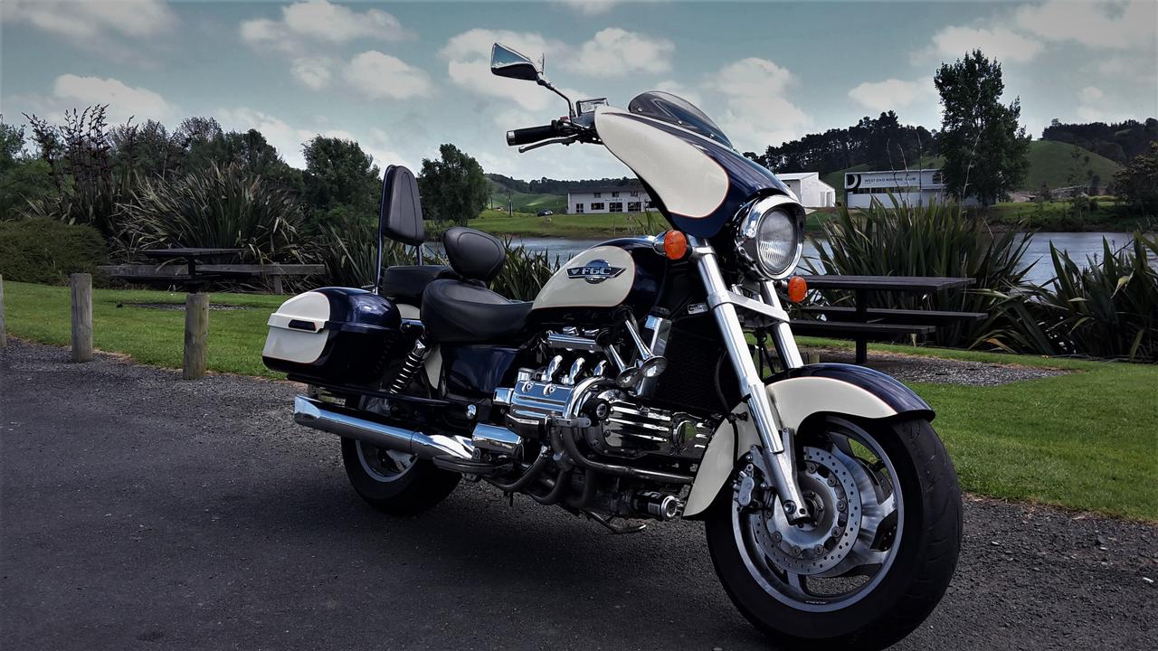

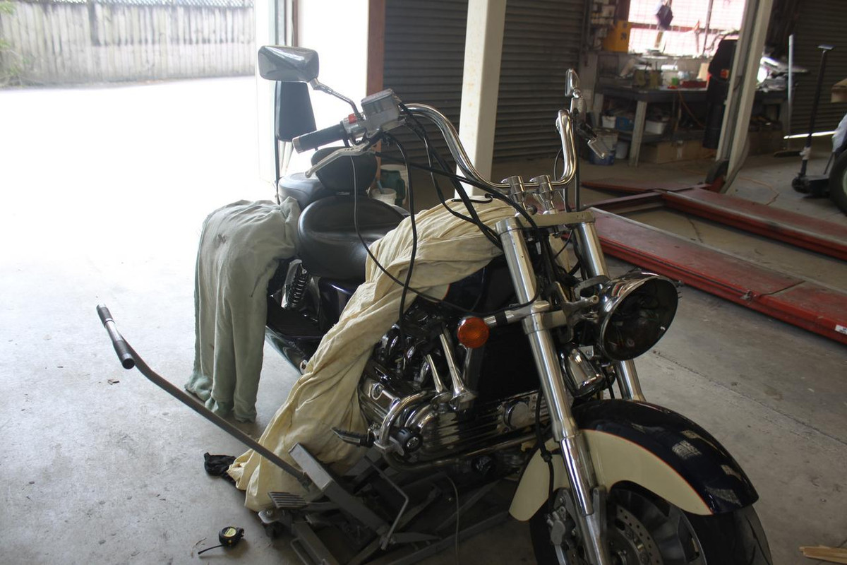

I found an old pic to compare Cheesy
I still like the no mods look, Would love 2 of the same bike and remove the rear seal and sissy bar on the second bike..... not going to happen any time soon though.....adventure bike first Smiley
mello dude
Posts: 951
Dayton Ohio
« Reply #17 on: November 15, 2018, 03:33:08 PM »
I still think the standard valk is the best looking of all the models. Yours looks great! Thanks for the pic.
