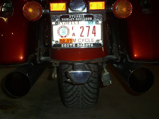

I bought this tire fore $83.03 from Belle Tire in Detroit.
Kelly Springfield Fierce
12K miles and no perceptible wear. Far better ride at highway speeds and great load capacity.
