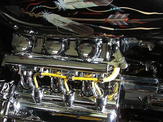

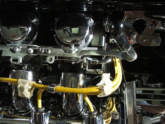

I got rid of that fool factory design and made my own choke lever setup. It's more positive, easy to use, and you're not going to break or stretch the cable from the handlebar down to the carbs. The first pic is construction in progress. The second is the completed unit. Been on there for years(12+) with no trouble or loss of function. If interested, I have another pic with drawings and dimensions, and can give a description of how to do it.
