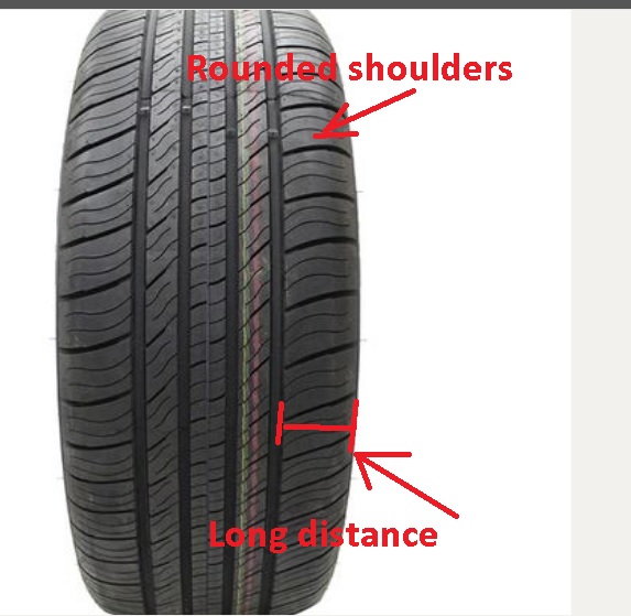

Last tire change, I went with the Hankook Champiro 205/55 R on the recommendation of a board member . I am very satisfied  with the tire,,, a vast improvement  over the Verdestein tire I used prior to it.

That looks like it,, notice in the straight on picture how rounded the transition to the sidewall appears. It handles pretty well for a car tire at low speed maneuvering.... to me.

I just noticed you said non Hankook tire Britman,,, and although it looks like the Hankook, it is not.  That is not the one I am using,, I have a genuine South Korean Hankook HA....   It really does handle well,, I run it at about 38 when cold.
If it has a downsize it is the 205/55 profile,, while I like the way the bike sits,, it makes sparks easily,, it has the RPM's up a bit at any given speed, limiting me to 33MPG if I am careful.  I did the "nut cage mod" on the right side before this tire and not sure it would have been necessary....  but it is probably a good idea.

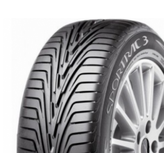

My favorite DS tire was Vredestein Sporttrack 3, but , unfortunately, it is no more available.
I liked it firstly for the riding qualification, but also for the look!
The last years tire patterns has changed to track alongside the tire again. It is my experience that such tracks should be as far into the middle of the tire as possible. When such tracks are more out on the shoulder, I ( and the passenger) can feel them in the curves .
So, rounded shoulders is  no 1
Secondly , when possible , no alongside tracks, and, if there are  such tracks , they should be as far as possible from the shoulders.

Just like the Champiro VP1
