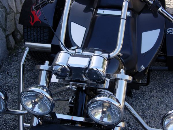

« Reply #12 on: November 28, 2009, 04:30:52 AM »
Joop
I saw a Boom trike recently with a nice infill between the two clocks that might look nice with some of your electronics in it and still leave room for a fuel gauge for the IS tanked and also various warning lights and possibly your indicator alarm. I have contacted Boom to see if they will just supply a shell and am awaiting a reply. What do you think? Might have room for an LCD display that could do the gear shifter and a clock and if you are reading the speedo input a digital speedo. Lots of ideas but I lack some of the electrical skills.
Colin

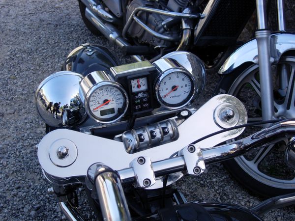

« Reply #19 on: May 12, 2010, 11:04:34 AM »
Joop sent me the Gear Indicator a few days ago.
It's exactly what I was  looking for. Great design, very useful, and easy to mount and connect (between 3 and 4 hours).
a few pics:
Joop's bike :
Valkyrie ...what else ?
