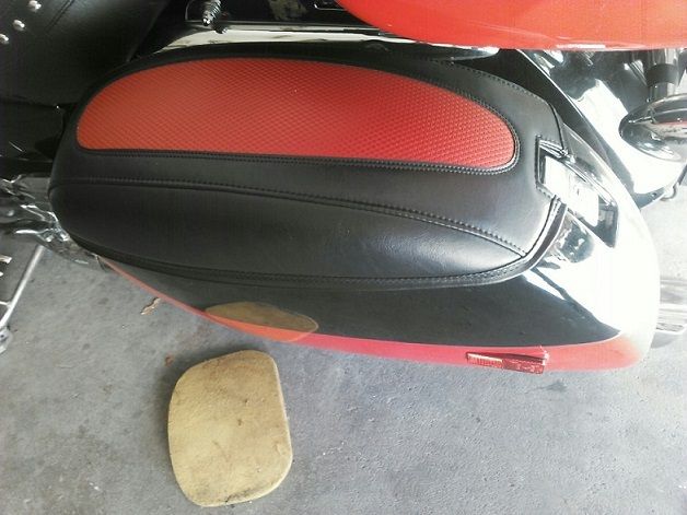

Hooter, I also remember what you remember.  IIRC, that person took his lids to an Amish(?) upholsterer to have the covers made.  Again, IIRC, they were covered in black vinyl, and they had obvious (but nice-looking) seams, unlike Hook's (which also look nice).

Yeah, I'm editing my post before I even post it.  I found the thread we remember:
http://www.valkyrieforum.com/bbs/index.php/topic,81482.msg800653.html
From that thread, henry 008's lid covers:

The only bike I ever saw with leather lid covers was Fudgie in Indiana (the EMT).  I can't remember ever seeing them for sale anywhere.

...From that thread, henry 008's lid covers...
Henry is local to me. I can get in touch if you want.
