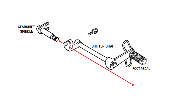

« Reply #8 on: January 26, 2019, 10:30:07 AM »
As already stated, the slot allows adjustment. Theoretically, the Jersey Bracket is suppose to line up with the gearshift spindle's axis. albeit, at that coordinate, the gearshift spindle's axis is an imaginary line. The design of the bracket does most of the work for you. Just fine tunning it a little.

« Reply #11 on: January 26, 2019, 11:09:04 AM »
Nice drawing RonW!  Exactly!  Took measurements of the Spindle and Shift Lever to get the exact offset, spline angles, frame mounting, etc. to identify how much slot angle was needed for ample adjustment... without making it too big.

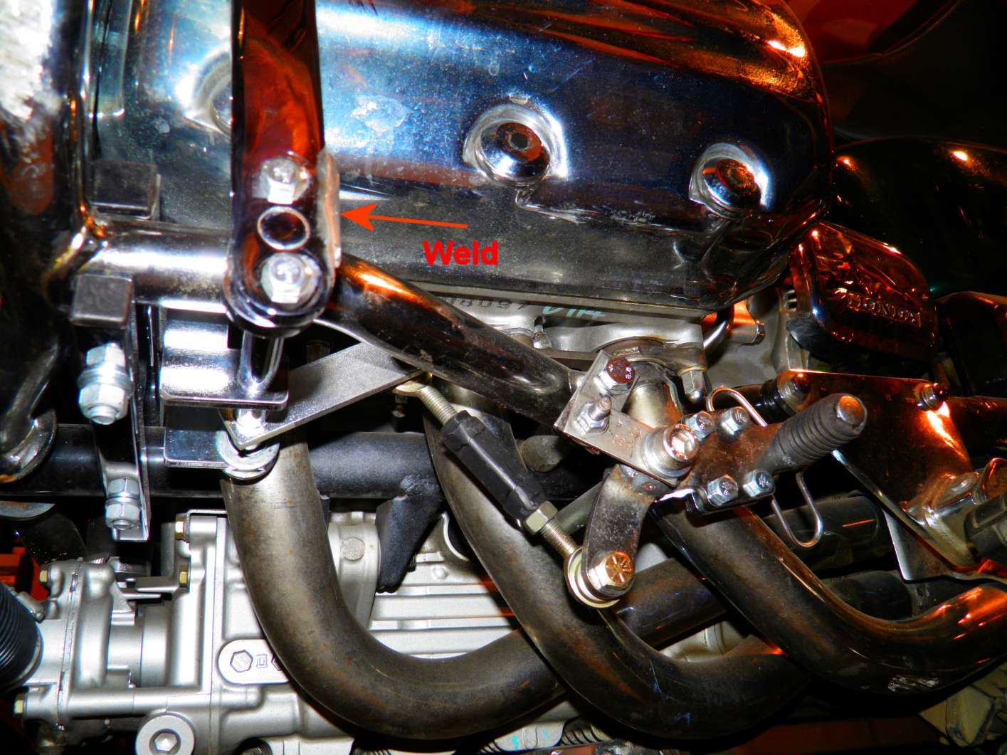

« Reply #32 on: February 11, 2019, 03:40:28 PM »
Any idea if this will work with on an Interstate with bigbikethings forward controls?
Posts: 5196
« Reply #33 on: February 12, 2019, 07:44:56 AM »
Not without some mod(s) but this may be trivial with some metalworking tools.  Here's the original Ammpro shifter mod, Jersey's mod is based on, modified slightly to work with BBT fwd controls.  There's a nut welded onto the outer face of the BBT shift lever clamp, coaxially to the shifter shaft, for the allen-headed bolt to screw into. Doesn't actually need much tightening for the Ammpro plate to be fixed to the BBT clamp.  Looks like you would need to provide clearance some way for the aft end of the Jersey arm, where it would collide with the clamp bolts. Note my BBT install is also modified a bit to improve it - note the intermediate connecting link with Heim joints on the ends.  Makes adjustment easier and more solid:
Compare that pic to Indybobm's pic from above:

« Reply #35 on: February 13, 2019, 05:03:25 AM »
Thanks MarkT... that's a great comparison.  The only thing I could see is in having some replacement pieces laser cut to get rid of the corners on the support braces.
