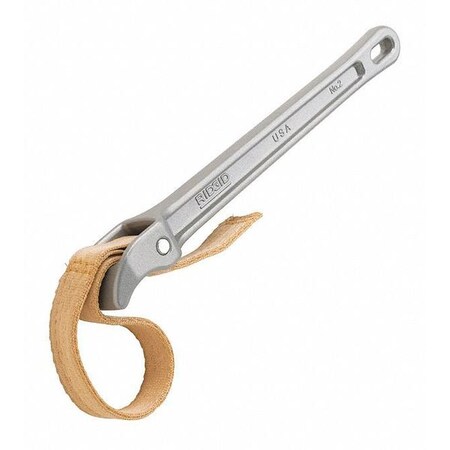

BTW - it's much easier to change the preload on the 444's with a strap wrench. The 444's have 8 turns of the top collar to adjust them and I defy you to do it with your hands like they claim.  I keep one in my road tools.  This one comes in a set of 2 - I actually use the bigger gray one.  Bonus you can use it to change your oil filter too.  I also use a modified McPherson strut spring compressor to help re-install the shocks after a tire change but that's another story.

I was able to change the preload with my hands on 440 Progressives, but only soon after I got them.
Later, even with spray lube, King Kong might have been able to, but I sure couldn't.  Getting mean with it only hurt my hands and wrists.
My strap wrench is an old fashioned one, and it takes me a half hour to figure it out, each time I use it.
This thing is like Rubic's Cube.

I sure am glad to learn that I am not the only one who has a hard time adjusting the 444's with my hands. I gave up on doing it barehanded and grabbed some rubber coated mechanics gloves which helped somewhat. The strap wrench sounds like the answer. My manhood has been reinstated.
