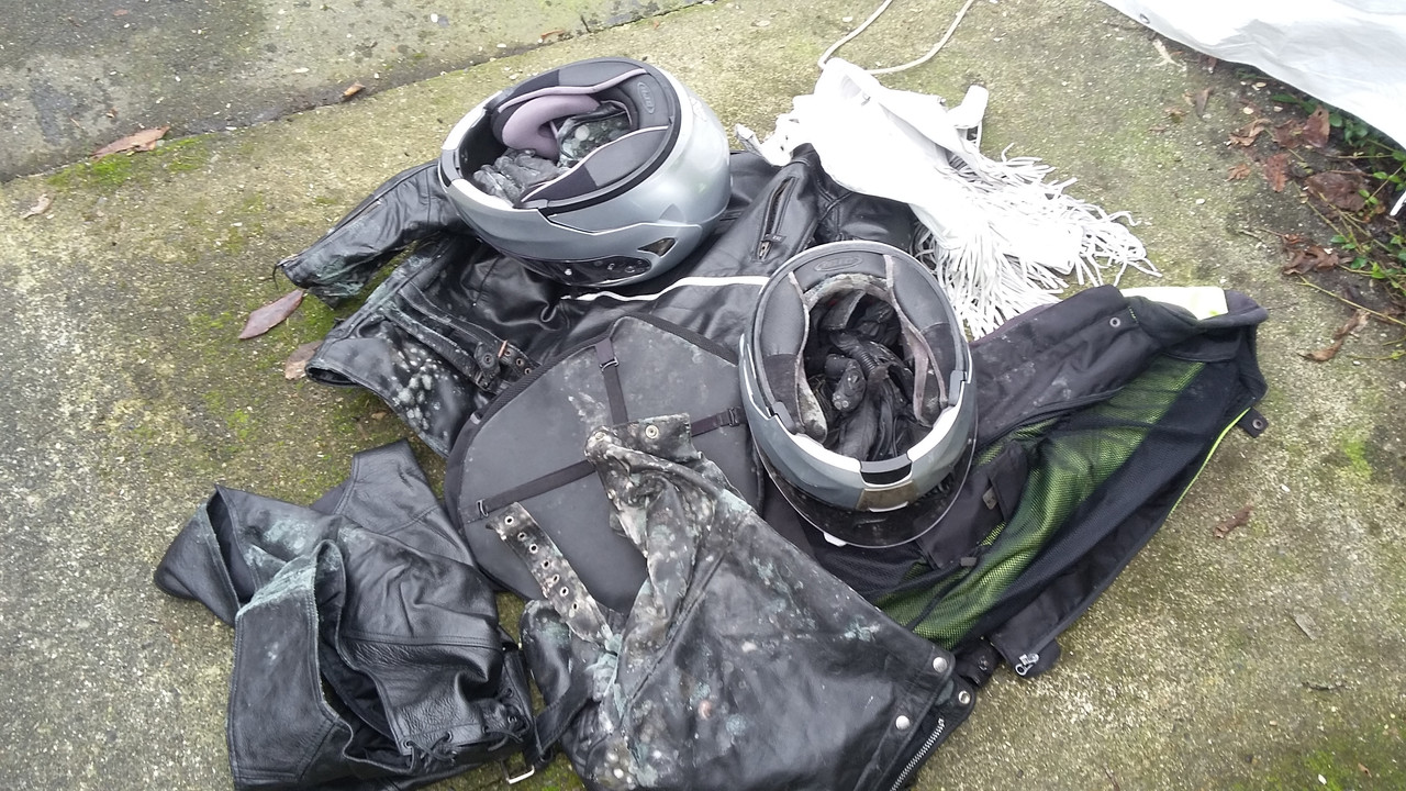

Well, what can I say, I parked my trailer outside with my gear in it. Was supposed to move it inside the garage, but after we where done, there was no room for everything that needed to be inside, so figured the trailer could stay outside.
I forgot that all my riding gear was inside it.
I opened it up so I could remove it all, and this is what I found.
 Cry

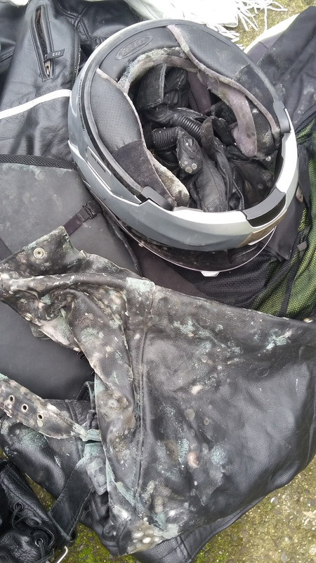

I've been researching how to clean it for over a week now. Seems the basic steps are to;
1) Kill the mold. Use an acid solution, 50/50 water/vinegar.
2) Clean the mold off the leather. Use a mild soap. Saddle soap, something mild that wont dry out the leather, Dawn dish soap, maybe Woolite or baby soap.
3) Preserve the leather. Leather conditioner, Neatsfoot oil.
There is a lot of how-to info out there, youtube, but then mine isn't a little mold, I have forests growing on it. First to fix my trailer. There was o-rings for sealing the bolt holes holding the rack on, which wasn't good enough. I replaced them with plumbing washers, big and thick, that I had to screw onto the bolts. Dried it out, and am now waiting on more rain, something we usually have a lot of during the winter, but not this one.
The textile material is easy, remove items I don't want to wash (padding) and place in the washer (front load), with a full cup of vinegar. Then the 50/50 solution to wash the padding off, and now needing a quick wash in a mild soap solution. In my case, I used a watered down solution of dish washing soap.
So far, so good. My jacket, Airhawk and face/neck shield has come out clean. I didn't remove the helmet padding yet, my wife doesn't want to but the helmet back on, no matter how clean I say it is, as she doesn't want to breath the mold. I can't blame her, so it looks like it's going to cost me a few $100's to buy new ones for the both of us.
Then on to the leather, most likely tomorrow. Since the gloves have mold inside also, along with the riding jacket having an inside liner, I will be soaking all the leathers in a 50/50 solution with some Woolite soap in it. Rinse it by hand in a basin full of it, and a second rinse after they have all been cleaned, with fresh water.
I've a jacket, vest, chaps and gloves, all needing this care. After they have been cleaned and dried, then I'll need to re-protect it, neatsfoot seems the best. I did buy some automotive leather conditioner which contained lanolin and neatsfoot.
I'm hoping that this will recover all my gear. I have nothing to lose, as the way it is right now, I need to replace it all. I don't think this will harm it overall, as I've been caught out in the rain before and got completely soaked, taking days to dry out. It's about time I recondition the leather anyways, and now I have too.

Have done a lot of recovery work on stored old cars where mold is a serious issue. As you know some mold has serious health issues and only an mold analysis can tell one from the other.
First thing to do is put on a good mask and move everything to a dry well vented area. Fan would not hurt.
Then bleach everything that can be bleached without damaging it. Bleach is a real mold killer.
Then on everything else use a damp paper towel (with or without mild soap and with and without bleach) to remove as much as you can. Dry everything well and expose it to sun as much as you can.
If using bleach, get as much bleach off as possible, flooding water or damp wiping.
Then use special cleaners (depending on material) to finish cleaning. Most work ok.
Note that oil products will make it easier for items to mildew in the future and the more oil the more mildew. So keep them as dry as possible when storing.
No real secrets just hard work.

I hate doing it, since a helmet is all synthetic, I figure it's one of the easiest to disinfect and clean, but since your face is in it, I need to agree with her on this one.  :'( Throw away a few $100's of helmets and buy them again, they where only about 2 years old.
Pete, thanks for the info, that jives with all I've read (except the bleach). Spray, wipe, dry, clean, wipe, dry. Keeping the leather as dry as possible. I've the mask already.
But in my case, I have very large areas (50-75%) and both sides. The other side isn't smooth, it's either lined (the jacket) and you can't see it, or unfinished and looks like cloth almost. Also my gloves
Right now, it's all outside in the garage, hanging. I'll take it down, and spray it with the 50/50 and clean off as much as I can. But then into a basin of the 50/50 and soap, and scrub it all down, cleaning the leather completely, inside and out. Rinse in 50/50 again, water, then pat dry and let hang and maybe a tumble dry with no heat and towels in the dryer for an hour 1st.

The leather all came out good.
I sprayed the mold with the vinegar, to retain any spores, outside. Wiped the leather clean, and made sure I soaked the backing. Then soaked the whole garment in a basin of 50/50 and some Woolite. The water came out black, I think from the leather dye, then took it outside and rinsed it off with the garden hose, then hung to dry.
I then placed pieces into the dryer with clean dry towels, and ran it on low heat using the moisture sensor to auto shut off. The chaps and vest dried nicely, but I didn't want to over due the jacket, so it's now hanging inside near the heater.
My wife thinks her gloves smell of mold, I think of vinegar. Just waiting on everything drying, then start to apply the leather conditioner. No signs of stains on the leather anywhere. No worse than riding in the rain for the day in our mountains.
Something mentioned, wet and then wipe off the mold. The reason is that the mold is on the leather, it does not get into it, so it only needs to be cleaned. But mine was covered on both sides by so much mold, I needed to soak them to insure I got it all.
« Last Edit: January 27, 2019, 09:25:38 PM by gordonv » Logged
