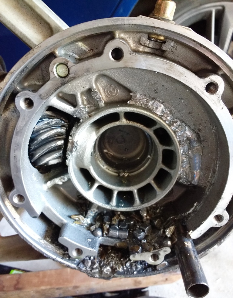

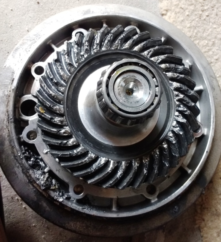

Last year I pulled the final drive from my old (1988) BMW R100GS.  I was planning to rebuild it because, amazingly, BMW still sells the parts.  After opening the case I saw that the damage was far worse than expected.  A bearing race had broken, causing the drive to completely lock up.
I found a good replacement on eBay for under $250.  I installed it and the old bike has been running great ever since.  With so many low mileage Valkyrie final drives available I'd be inclined to replace it and keep the old one for a spare.
BTW, here's what major final drive damage looks like!

« Reply #6 on: March 12, 2019, 04:04:16 AM »
If you were riding this when it happened the pucker factor must have been enormous!
So many roads, so little time
VRCC # 5258
F6Dave
Posts: 2261
« Reply #7 on: March 12, 2019, 05:45:42 AM »
It definitely got my attention.  Luckily it happened as I was coming to a stop at a traffic light, at about a walking pace.  I had to get out of the intersection so I backed up a few inches, which must have dislodged some of the fragments, as I was able to ride it through.  I was about a mile from home so I continued riding.  It locked up twice more on the way, certainly adding to the damage.
