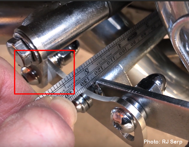

Just a heads up for anyone that has this piece of equipment. I helped a friend install his and it worked great for a few months. Lately he has had trouble shifting. I Looked yesterday and found the problem. In order to go through the gears the shifter has to return to center or it won’t make the next shift. His brace apparently tightened itself during normal use so that the pivoting joint became too tight and would not allow the shifter to return. Simply loosening that bolt fixed it right up.

Was the nylon washer in there?

Pretty sure that nylon washer is there. Turns out the two or three other readjustments fixed it and not the slight loosening of that elbow joint bolt. Apparently changing the torque on that bolt is unauthorized. I had a talk with the designer of the unit and long story short. Don’t mess with that bolt. Re double check the rest if the installation and insure the bolt holding the OE shift lever is good and tight

Chris,
I see the issue.  It appears from your photos that the spacer behind the center 6mm bolt (that lines up with the main spline) is out of place.  Please take a look at the updated instructions I just posted to my website.  It now provides an exploded parts view to show how the parts are to line up.  This is what was probably causing the two pieces of the Jersey Bracket to come out of alignment.
https://drive.google.com/file/d/14kS0x2iXMF87w2JQCj2TqQ2YDQ8t8uuY/view

« Reply #64 on: September 23, 2019, 08:30:01 AM »
the photo was a screenshot that I took of RJ Serp's video on YouTube,
https://youtu.be/MbVOFGWrI9g?t=80
Yeah, notice he also has a number of components out of place.  Washer and spacers are as originally designed, but if it works....  Just wonder if there's any binding that's not showing up yet.
