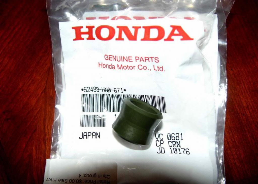

ok I think I found the culprit making all the noise, I think its either the driver side shock bushing, or the shock itself.
 I was able to locate the area where the noise was coming from, and spayed a little lubricating fluid on the the bushing and the top area of the shock, it quieted the noise down, but went riding yesterday and somewhere along the 300 mile ride, the squeaking returned.
 The bushing looks a little deformed, like it has been over tightened and squished some of the rubber bushing. Could that be the culprit ?

          The bushing just gets deformed from use and the vertical-well canted-motion is transitioned to the bushing which deforms the bushing. Replace uppers and lower bushings-4 total=top and bottom on each shock. First time I figured out What was wrong I had a pretty good wobble coming down an off ramp throttle rolled off and just about turned into a tank slapper!  Lips Sealed That'll git yer tenshun!  2funny RIDE SAFE.
Yes. Try some of the bushings for the VTX. They are 2 piece units that hold up much better.
VTX bushings are not split into two pieces.  There is at least one aftermarket bushing that is, but not the ones from Honda.
My bad  Sad I have both the VTX ones and the aftermarket green ones. I get them mixed up.

ok I am going to replace the shock bushings and hope that cures it, really don't want to buy new shocks right now...if it comes to buying new shocks, how good are the Progressive 444's....I am a fat guy ,but slowly losing the weight...377lbs now, at the last Inzane I was at 424lbs...I usually ride solo but would like a shock that can handle me plus any luggage or a passenger .
