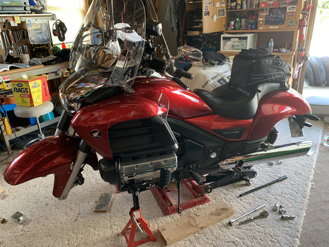

« Reply #27 on: July 22, 2021, 04:49:26 PM » |
The bike under the crash bars and the bottom joint on the shock or spring is rock solid and easy to do.
« Reply #28 on: August 09, 2021, 07:23:52 AM » |
I made the wood adapter. it fitted like a glove with the bike on the side stand.
I put the adapter on top of my Craftsman lift.
Tried to push it under the bike. Nope. Not going. The rear blocks are too tall. I made those from 2 pieces so I remover one making the block shorter. Nope still not going. Not even with the bike upright.
Base of my adapter is plywood.
I stand on the lift to make sure it's fully lowered.
Nope still not going under the bike.
I remove the rear block completely.
Now the remains of the adapter will go under the bike but I need to have support under the engine guards when I leave the bike without the front wheel in place.
When you put the bike almost upright there is more ground clearance maybe you can slide the adapter under when it is almost totally upright. The shock mounting in the rear is a great jack point for the rear of the bike. The engine guards work well in most circumstances. I hate to say it but 2 jacks one under the rear shock mount and one with adapter under the engine guards would allow full access to the bottom of the bike. A jack under the back shock mount allows just enough clearance to get the rear tire out. The problem with adapters is you have to remove them to service anything under the bike.

« Reply #31 on: August 15, 2021, 03:26:50 PM » |
The bike under the crash bars and the bottom joint on the shock or spring is rock solid and easy to do.  Robert, do you own a shop, or is that your personal garage lift? Nice setup for sure.
