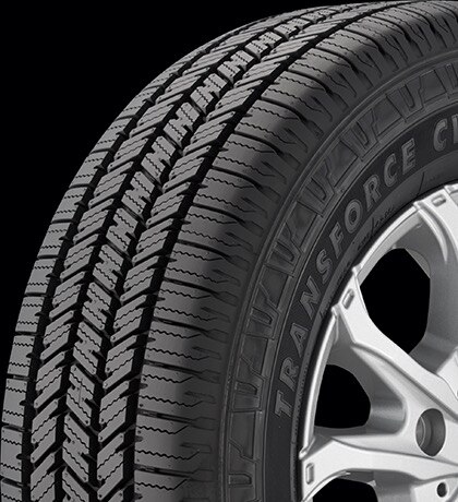

« Reply #4 on: May 18, 2019, 06:16:01 AM »
Found this tire as a replacement for the Austone.  Tall profile at 27.5" diameter a bit more than the ATT, 5.6" tread width slightly wider, and with rounded corners.  Also cheaper than the ATT, and Firestone brand.  $123.91 with free shipping, in stock now.  Size is 195/75R 16C
https://www.tirerack.com/tires/tires.jsp?tireMake=Firestone&tireModel=Transforce%20CV&partnum=975R6TCV&vehicleSearch=false&fromCompare1=yes&fbclid=IwAR2eOBvHQ8iKtWzeBLbQV5Qp42nJaQgi8-Bq1OzLL3E2gk70Y-sb4Di7ihU

« Reply #6 on: May 18, 2019, 03:33:05 PM »
Looks promising Mark, very similar to the Austone in profile and tread pattern.  Did you see any info on sidewall ply?  I really liked that stiff sidewall on the Taxi Tire.

« Reply #7 on: May 18, 2019, 05:48:19 PM »
Pressure rated at 69#, load capacity 2150#; comparable to load range C; 3-ply though it doesn't say that in the specs given.  Makes it a light truck tire and should be pretty thick sidewalls.  Made in Costa Rica - NOT CHINA.  If I didn't already have another new Austone on hand I'd order this one now.
From the description:
The Transforce CV is Firestone's Commercial Highway All-Season light truck tire developed for the drivers of vans, delivery trucks and multi-purpose vehicles that transport heavy loads. Available in heavy-duty, Euro-metric Commercial Vehicle (designated by the suffix C, not to be confused with LT-metric Load Range C) sizes, the Transforce CV is designed to deliver long life and comfort, even while hauling heavy loads, in addition to providing predictable handling on dry and wet roads, as well as in light snow.
Utilizing an all-season compound, the Transforce CV is molded into a symmetric pattern with an optimized tread profile to help resist uneven wear. The updated tread pattern is also designed for chip- and tear-resistance on coarse surfaces. Wide, circumferential grooves and full-depth lateral slots help evacuate water to reduce hydroplaning, and Saw Tooth Edge Siping delivers the biting edges needed for traction in slippery conditions while also maintaining stability of the tread blocks.

« Reply #8 on: May 22, 2019, 09:57:14 AM »
That Firestone looks to be the most promising alternative I've seen so far. I'd be curious to hear about the the difference from someone who previously ran the ATT.
