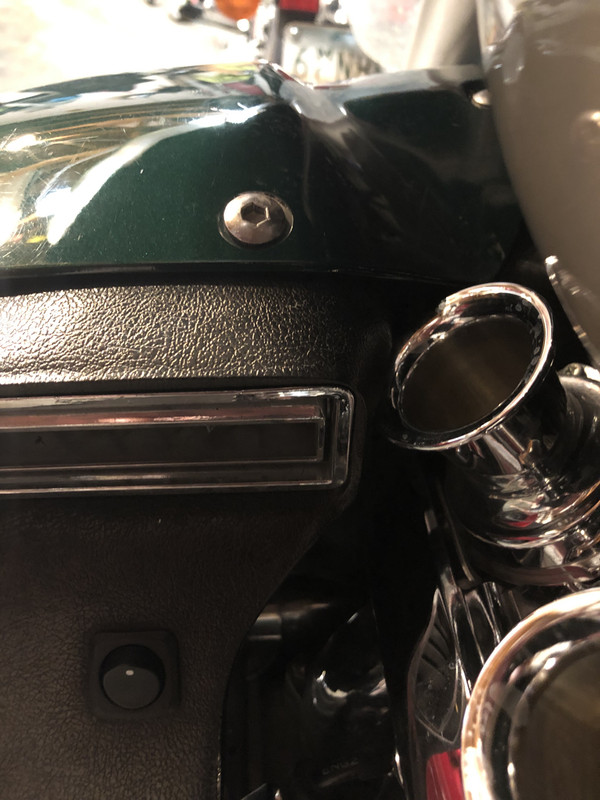

Asking owners of Interstates that have velocity stacks installed. What did you have to do to install them? Post pics if you got them. Thanks!

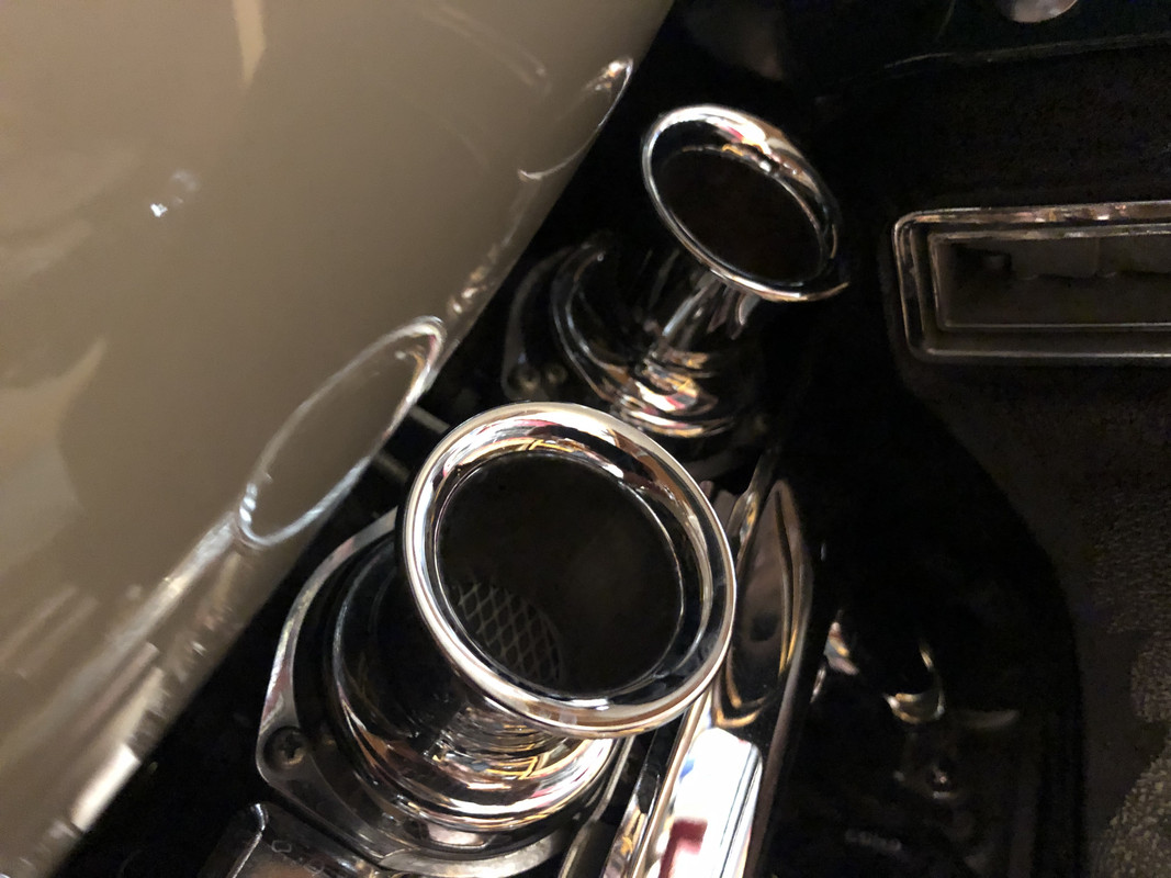

I have them on Deerslayer which has an IS tank.  I added big fender washers under the front and rear mount tabs at the bolts until there was enough clearance.  No biggy.  Your seat nose might get tighter.  You can see them on this link.  https://www.youtube.com/watch?v=NnVHvs_H_IM
« Last Edit: May 16, 2019, 09:56:43 AM by MarkT » Logged

I installed V-stacks on my 97 with a Interstate tank but I did some mods which I illustrated in the article below…...
http://www.valkyrieriders.com/shoptalk/vstackspacermod.pdf

Yes, they will fit. You will have to trim a little plastic on the inside of the right side. And put a 3/4” spacer under the front tank mount. With that, you will then need to add a little extra rubber under the tank rubbers on the frame rails. All very easily done.  cooldude

 The v-stacks were a lot cheaper than the pods  so I cut up the v-stacks. I also raised the tank front and back. The v-stacks are plastic so were easy to file to shape. I'm happy with the finished product

I lifted the front of the tank about 1/2 inch.
