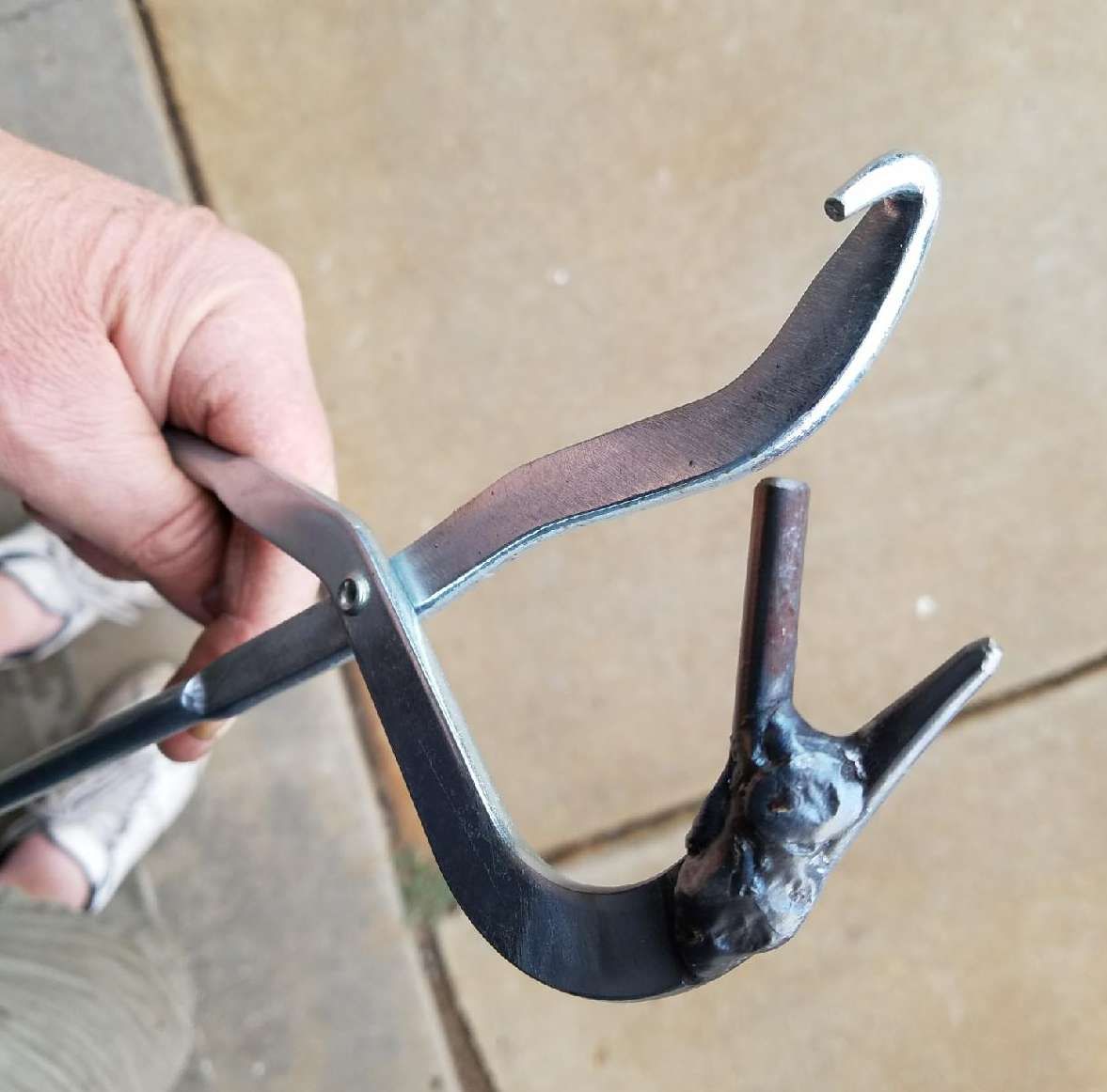

« Reply #17 on: June 08, 2019, 06:23:32 PM »
I modified this brake spring plier specifically to install sidestand springs.  I'll be there with this and a lot more tools tomorrow evening.

« Reply #18 on: June 08, 2019, 08:42:23 PM »
Mark, that thing looks like a tool from the Spanish Inquisition.   Grin

« Reply #20 on: June 09, 2019, 07:40:00 AM »
That puny weld is gonna break!! Shocked
