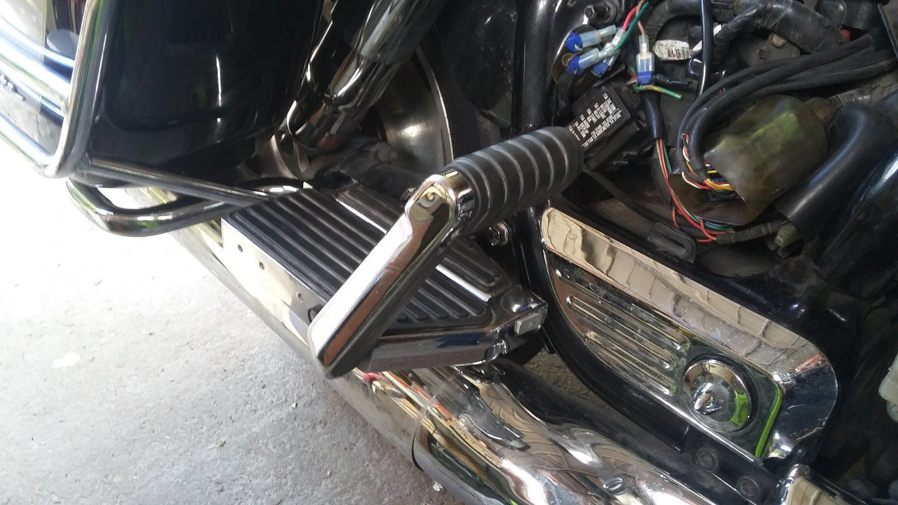

You can see the clear (darkened) cover on the right, there is a blue and yellow 30 more or less pin plug there. This comes from the radio under the seat. Just find the radio, follow the wires out of it, and insure they are all plugged in somewhere.
