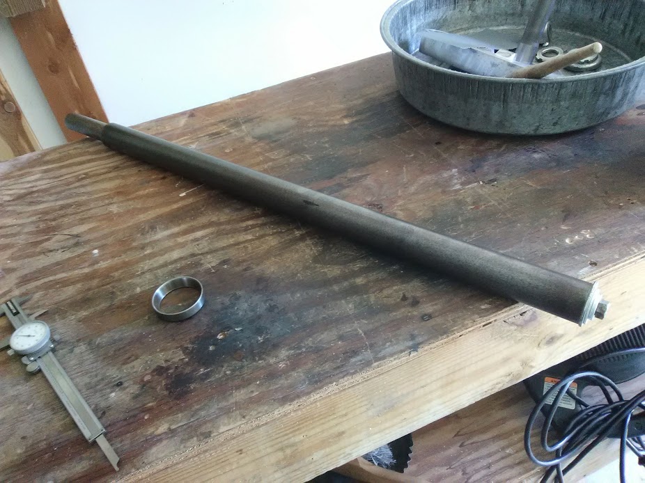

« Reply #16 on: September 02, 2019, 03:49:53 PM »
Here is the tool I made to remove the bottom outer race. Three foot piece of 1 1/2 inch mill finished bar,, gives outer diameter of 1.560 which is a firm fit in the neck with hardly any  wobble. Drilled and tapped  7/16 and some washers locked on offset when it is put in place. At 16 plus pounds, the mass helped the race come out easily when struck with a hammer, moving the washer back and forth.
I ground the top edge of the washer that contacts the race so it fits the provided space more precisely. I found a washer in my bins that was the correct size and had a sharp transition from the flat sides to the edge, not rounded like many washers. Once the race moves off it's seat, there is more room to get a good bite, but the tool worked fine.
Just need to clean up the stuff I removed, and hopefully the bearing kit will arrive tomorrow and I can get back on the road.

« Reply #17 on: September 03, 2019, 06:37:14 AM »
Pancho, just for information check out Park Tool lower steering stem bearing puller., CRP- 2........ since I seem to be the neighborhood sucker MC tech who works for beers..I bought one... does the job......I ll post pics when I get to my desktop.....
« Last Edit: September 03, 2019, 06:49:06 AM by mello dude » Logged

I'll check the tool out dude, but I got to tell you, mine works pretty good, just can't fit it in a tool box, and at 16 plus pounds certainly don't want to use it after a few beers and drop it on your toe!
I see, not a race remover, but a bearing remover, have you checked to see if it will do a Valkyrie? Now that I milled that trough I should have no problems in the future. If I start repairing motorcycles again I'll keep it in mind, looks like it should do most.
« Last Edit: September 03, 2019, 03:42:03 PM by pancho » Logged
