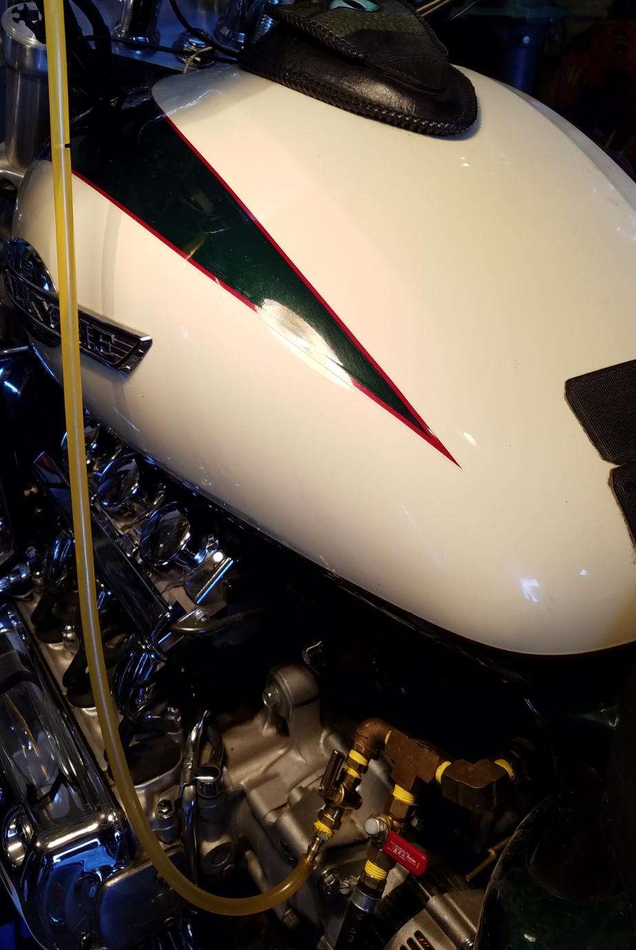

Posts: 5196
« Reply #19 on: September 05, 2019, 10:37:18 AM »
Apparently some people erroneously think that pulling fuel through the reserve port provides a greater head pressure below the petcock.
That is simply not the case, the head pressure is dependent on the surface level in the tank providing the restriction thru the petcock for the two routes is not different. cooldude
This is absolutely correct and I proved it.
If the pressure is higher with the fuel pickup at the bottom of the pickup tube above the petcock, than it is at the top of the tube - that is from the reserve feed than the main tank - then taking a transparent fuel line from the petcock, turned and routed back up above the fuel level, should show the fuel level higher when fed from the reserve rather than the main port, right?  Think of that a second.
Now look at this picture.  I did exactly that with this piece of fuel line.
The fuel level line was marked for the reserve level - note the mark at the fuel level.  Switching to the main feed, the level didn't move.  AT ALL.  And it makes sense.  The column of liquid is exactly the same height in both cases.  In one case that column passes through the feeder tube.  In the other it bypasses it.  The height of the column is the same in both cases and thus, the pressure.  IOW, also think of a siphon with a transparent hose.  It matters not the route it takes - the level in the hose after it passes up and over the high point, dips down low than is turned back up again above the level of the container's contents, will be at the same height as the level in the container being siphoned no matter what route is taken.

Cracker Jack
Posts: 558
« Reply #21 on: September 05, 2019, 08:11:13 PM »
Mark, thanks for describing your experiment which demonstrates what everyone who has taken a fluids/hydraulics class already knew. cooldude
RWhitehouse, what you're erroneously not considering is the head developed inside the normal pickup tube. coolsmiley
