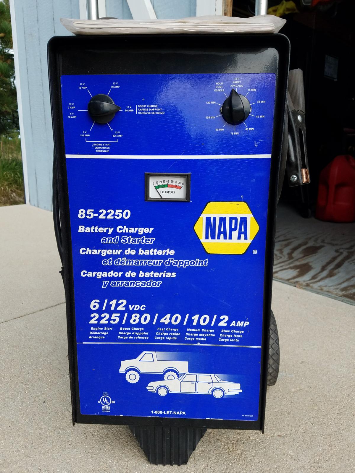

Posts: 5196
« Reply #11 on: September 07, 2019, 07:04:05 AM »
This large manual analog charger is very useful for initial charge, as well as desulfating drained batteries, and jump starting.  If I need to charge for longer than the onboard timer, I just set it to HOLD ON and set an alarm to remind me.
