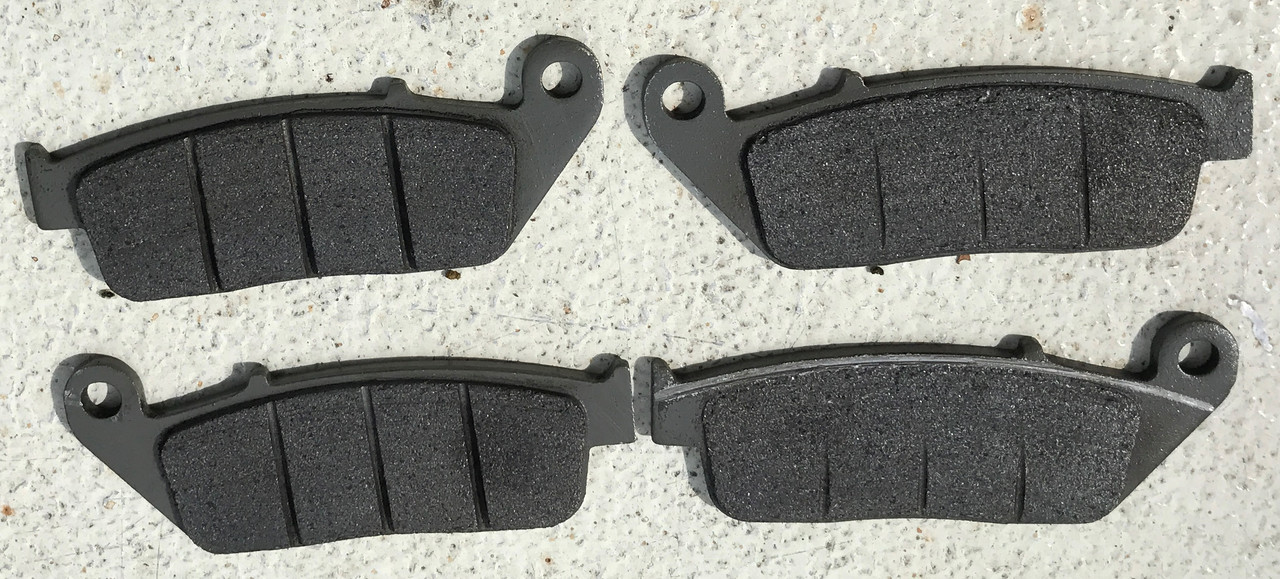

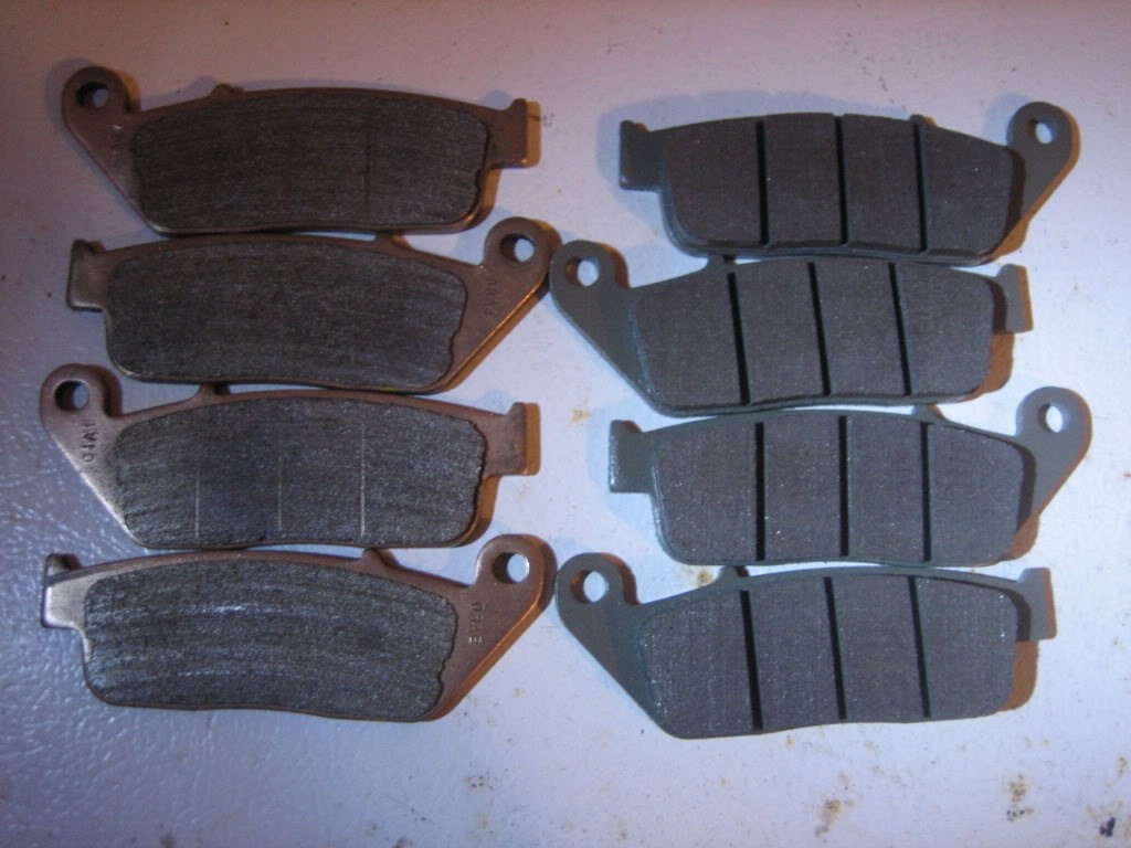

My OEM pads wore out after 20,500 miles.

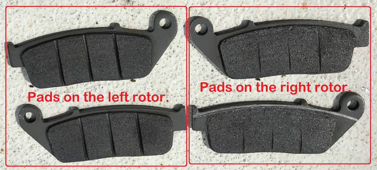

I bought 4 sets of pads (eight pads total, or enough for two complete brake jobs). The first set lasted 22,500 miles and wore evenly (no pic).
BUT, I wore out the right pads on the second set in only 8,300 miles.
Each time I changed the brakes, I cleaned the pistons prior to compressing them. The right side compressed today enough to remove the caliper without undo pressure.
Would you recommend just expanding the pistons and cleaning them, or should I disassemble the caliper? Obviously, the right side is dragging.

The uneven wear on the pads indicate the problem is the "floating" part of the caliper.
The caliper is not properly "floating" as it was designed to do.
It's dirty and sticking and is not being allowed to properly seek it's neutral position.
That's your problem.
Not only that but because of your problem, you've probably have worn the rotors unevenly also.
And that cannot be corrected except by replacing with new rotors.
Which is what a consciencence rider would do, who worries about that stuff.

The uneven wear on the pads indicate the problem is the "floating" part of the caliper. . . .
The brake pads wore evenly on each rotor, it was just that the pads on the right rotor wore out prematurely. That does not seem to me to indicate a "floating" problem. Maybe I'm missing something.
I think RickyD is right.  It's not just the pads that move, the whole caliper is supposed to slide back and forth on the caliper mounting pins.  If it is stuck in place, the pads will wear prematurely.

I think RickyD is right.  It's not just the pads that move, the whole caliper is supposed to slide back and forth on the caliper mounting pins.  If it is stuck in place, the pads will wear prematurely. . . .
As I responded to RickyD, maybe I’m missing something. But you will have to explain this to me.
The identical wear to the inboard and outboard pads tells me the caliper was exactly centered over the rotor during the entire life of the pads–the caliper was moving freely.
If the caliper was stuck, I would expect the outboard pad would show substantial wear (the pistons pushing the pad against the rotor), while the inboard pad would show little to no wear (the pad frozen in place on the stuck caliper).
This is not rocket science.
Both pads showing the same excessive wear tells me the caliper is not completely releasing. In my experience with cars, this is caused by a either a defect in the caliper, or a defect with the flexible hose to the caliper not allowing the brake fluid to flow freely.

When I am wrong, I will admit being wrong. As suggested by RickyD and Valkpilot, the right caliper was not properly "floating" as it was designed to do. The slider pin was covered with rust and it took a few taps from my ball peen hammer to convince the caliper to separate from the mounting bracket.
Removed the rust, cleaned and rebuilt the calipers, and reinstalled with new pads and healthy dose of lubricant.
I still am troubled by the phenomenon that both pads wore evenly, but there is no doubt the excessive wear was due to the stuck caliper. I owe RickyD and Valkpilot an apology as I rejected their absolutely correct diagnosis and advice.
