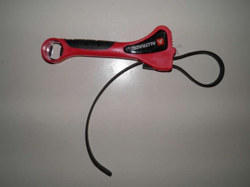

I have 444's the successor to the 440's.  It has 8 turns preload.  I don't try to turn it by hand.  Use a strap wrench.  I run mine at full preload for my springs and weight.  Also pull trailers OR have a co-rider. Almost never both. YMMV.  This wrench comes in pkg of 2 sizes, this is the smaller, I use the bigger one.
