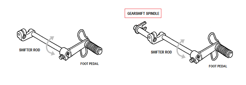

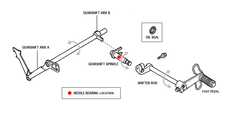

If you look at how the shifter is put together, and how long it is, you get an idea why the support is needed: https://www.partzilla.com/catalog/honda/motorcycle/1998/gl1500ct-a-valkyrie-tourer/pedal
The bearings inside the case are good, but even they have a limit.

Agreed, when the gearshift spindle is added to the length of the shifter rod, it's a longer pry bar acting on the needle bearings (red dot, bottom pic). Double-row needle bearings, but still.
