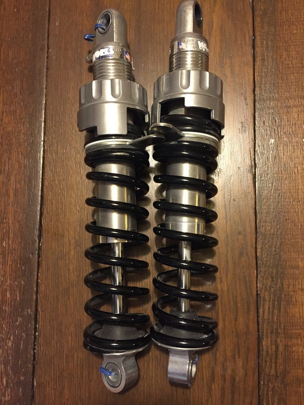

I'm looking at Worx Shocks when I finally pull the trigger to replace mine.
Shop is run by the daughter of guy who used to run Works Performance.
Website seems to be having issues, but you can likely find them on FB or just send them an email.
http://www.worxshocks.com/

I installed some rebuilt Works shocks in 2008. Eleven years and 36,000 miles later, I am still happy. I'm slightly more than your 245 pounds and sometimes have a passenger, and the shocks are better then OEMs (I never tried OEM Interstate).
I have no idea if they still make shocks for Valkyries (or are even still in business). They were located in Canoga Park, CA. Works Performance Products, Inc.
Works Performance closed a while ago after the owner passed away... his daughter has re-opened Worx Shocks.

Keep us informed on the shocks … I'm interested in the ride height and preload adj separated

I guess know one knows what shocks have both ride height and preload as separate adjustments?
Almost all just use preload to change ride height. A separate height adj is a plus, which Works shocks
had.
