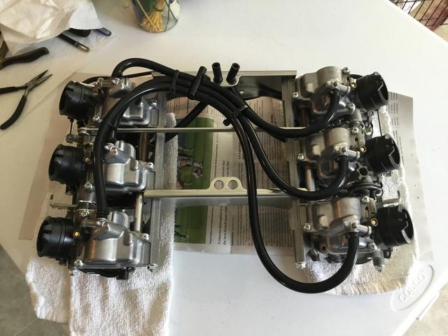

« Reply #9 on: November 10, 2019, 07:22:34 AM »
Just did the whole Red-Eye to the bike I bought this past spring, It's always had a slight gasoline smell around the carburetors.
Yes getting them separated was a bit tedious, as well as getting all the springs in, the airbox install was easy, a little bit of NAPA sil-glyd on the runners helps, compared to an airbox on an in-line 4 this thing is gravy.
shot all the passages with carb cleaner then blasted with air, then in the ultra sonic at 50c for 18 min. with simple green HD  way diluted, then all passages blown out again.
all of the Orings in the fuel rails were deteriorated and had yellow crust on them, and every air cut hose was cracked.
