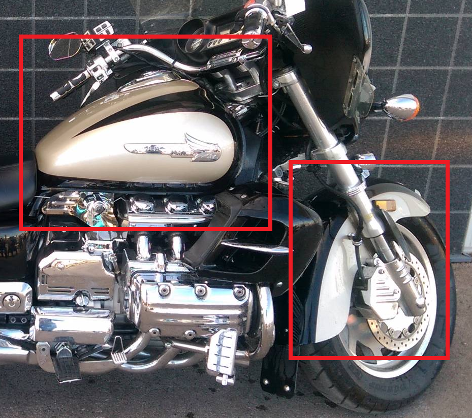

 I am going to have to paint my Valkyrie because of the crash it was in before I got it. My question is about the emblems on the tank and bags. How do I get them off and how can I put them back on after the new paint is done.   Thank Dannie
1970 CB750JDM, 1975 GL1000, 1979 GL1000 semi cafe, 1979 CBX, 1995 GL1500 SE, 2008 GL1800 trike. Several more not running yet.
Posts: 30975
« Reply #1 on: October 27, 2019, 05:43:55 PM »
Held on with double sided tape.
Warm them up (not high heat) and use dental floss or fishing line.
Tape them back on.
« Reply #2 on: October 27, 2019, 06:49:06 PM »
Fishing line does a fine job. I didnt even attempt to heat mine. Just back and forth sawing motion and off they came.

Use 3M molding tape to reattach, in an appropriate width.  Be sure to pre-mark the right location, as this stuff STICKS:

just for the price reference point I got my new to me interstate gas tank prepped (sanded, primed, etc) and painted (bunch of coats of factory paint and special epoxy sealant and 4 coats of the best clear coat available on the market) by one of the local MC painters, a.k.a. Da Vinci Smiley for $500 and front fender for another $300, so your quote of a $1000 for everything is very good in my opinion assuming the quality is top notch

Be very careful with the heat on that emblem, the emblem has a plastic base with what almost seems like a chrome skin. It doesn't take much heat to wrinkle that skin. I used a small heat gun that I use for shrink tube and wrinkled one enough to bother me, picked up a new/used one.

That looks suspiciously like an alternator cover.
pancho
Posts: 2118
Bonanza Arkansas
« Reply #18 on: October 30, 2019, 03:24:42 PM »
Or an old Silverado grille.
I believe it is different expansion coefficients between the plastic base and chrome overlay.
