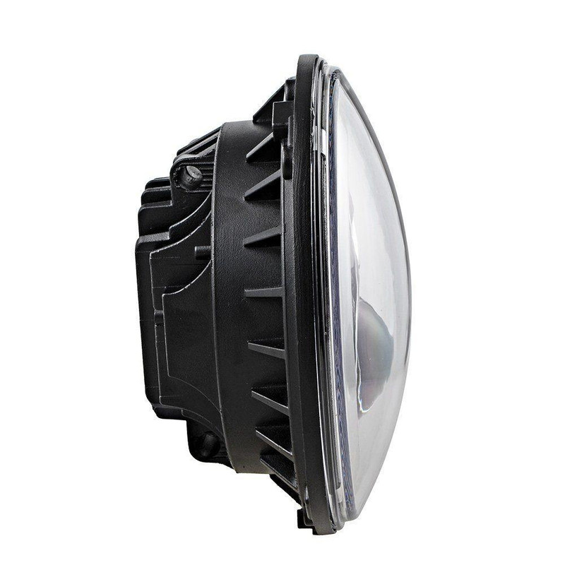

I just installed the, Relatively , new JW SPEAKER "Adaptive headlight" . An LED  which as some of you may know, is  designed to  illuminate around the corner as you lean... it really works .  It has about the same footprint as the Daymaker  full LED bulb...  I used a chrome ring from "Headwinds" which required a little modification...but was only $11.00 plus shipping from CO. Really pretty pricey but man...what an output...only 3.5 and 4.0 amps. draw.

« Reply #18 on: November 09, 2019, 05:22:59 PM »
yeAh I will call BS on it illuminating around a corner. Unless he has a special mod that does this for him. (Is wich was not a available in the years the valk was made).
« Reply #19 on: November 09, 2019, 06:21:40 PM »
https://www.jwspeaker.com/adaptive-2-series-led-motorcycle-headlight/
« Reply #20 on: November 09, 2019, 06:24:43 PM »
Not made for Honda  Shocked Shocked Shocked
https://www.jwspeaker.com/YMM/

Not to take away from Josh, but some aren't aware that there is another alternative. SLK Customs makes a lamp assembly for the Valkyrie; no adapter needed https://amzn.to/348Yb9J. I have not purchased or used the SLK lamp, so I have no opinion on it's quality. I'm just letting people on the board know their options. Again, not trying to cut into Josh's sales. As a matter of fact, once again, I'm a happy customer of his, and readily endorse his bracket.
You'd think that headlights would be cut and dry; a verified light output tested and ranked. But it doesn't seem to work that way. Take any light. Some will love it, and others will hate it. We all see things through our own eyes, so I guess that's why there are so many options.
The SLK headlights are literally $50 things off Alibaba. They are 50 watt fixtures, so take more to power than stock. No warranty junk that SLK doubles the price on and rips of my fellow Valkyrie brethren. The SLK guys don't even own a Valkyrie.
As a reminder, the Eagle Lights I offer are only 40 Watts (save your alternator), and have a lifetime warranty. And I have many different options available.

Installed the day maker head light and driving lights on the cobra bar from Josh and am very satisfied with the results!
The Tourer is well illuminated,now if I could get the same results on the I/Sit would be great   Smiley

What brand daymaker headlights? Josh's adapter is for Eagle brand, albeit not exclusively though.

Is this Josh's adapter bracket?
https://www.amazon.com/Eagle-Lights-Valkyrie-Projection-Headlight/dp/B07GT4YSJL?th=1

Yes it is. I rep and sell through Eagle Lights. You can also purchase through myself which most like to do since the VRCC knows and trusts me  Smiley.
Email me ValkyrieJosh@gmail.com to buy.
The beautiful thing about my Adapter Bracket is that it works with just about any DayMaker style headlight, which means you can choose your own. Just make sure it's this style/shape.
I Rep Eagle Lights because I have found them to provide high quality headlights that preform at competitive price (compare to JW Speaker).
