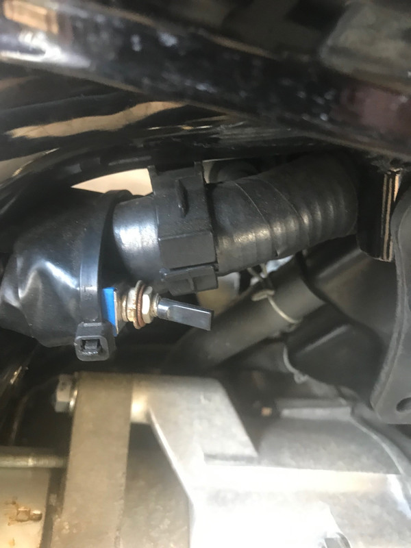

I just got this Valk and it has a goofy switch in front of the battery box on the ignition side of the bike.  The wiring from the switch goes to the battery neg (with an in-line fuse) and the other wire goes into a wiring harness. Then it looks like it attaches to a flasher and goes to the back of the bike. I can't see where flipping the switch does anything - bike on or off - brakes applied or not - blinker on or not - high beam or low beam.
Any ideas?

  Congrats on getting the best bike . I would trace the wire back to find the end. Previous owners do strange things , some good , some bad. I have removed a lot of after market wiring jobs that were a hazard. Best to know before the fire show. Evil

From your description, it sounds like they were trying to break the ground with a flasher to make a blinking brake light. In any event I would do as da prez says and get it off of there. I found and un-fused extra switch on my I/S when I got her. The PO removed some running lights and taped the bare wires to the crash bar. Could have been interesting if I had turned the switch on.  Cry

I think it makes the license plate frame flash when I hit the brakes.  I just noticed that the license plate has red LED lights that flash when I stop.  The switch doesn't make it change, so maybe the switch is defective, but there is an in-line flasher on the line.  I'll explore it more when I'm in a mood to both explore it and put it back right.
