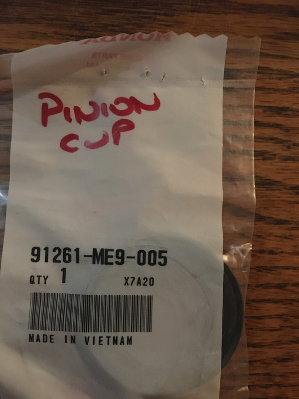

Anybody know the part number for the seal that rides the drive shaft into the differential
Thank you.

91261-ME9-005
Should be about $8

Dealer is telling me it’s 91202-MEB-671

Quote from: Steel cowboy on December 13, 2019, 12:16:44 PM
Go with meathead's number, not your dealer
91202-MEB-671 isn't for a Valkyrie at all...
https://www.partzilla.com/product/honda/91202-MEB-671
91261-ME9-005 is on the Valkyrie swingarm fiche page...

Are you sure you need one? There is suppose to be drive unit oil in the pinion cup.

Quote from: sandy on December 13, 2019, 07:33:44 PM
One of mine had become loose enough that it rode up the shaft a ways, not sealing up the pinion cup. It's probably just as important for keeping water and grit out as it is for keeping the gear oil & grease in.
