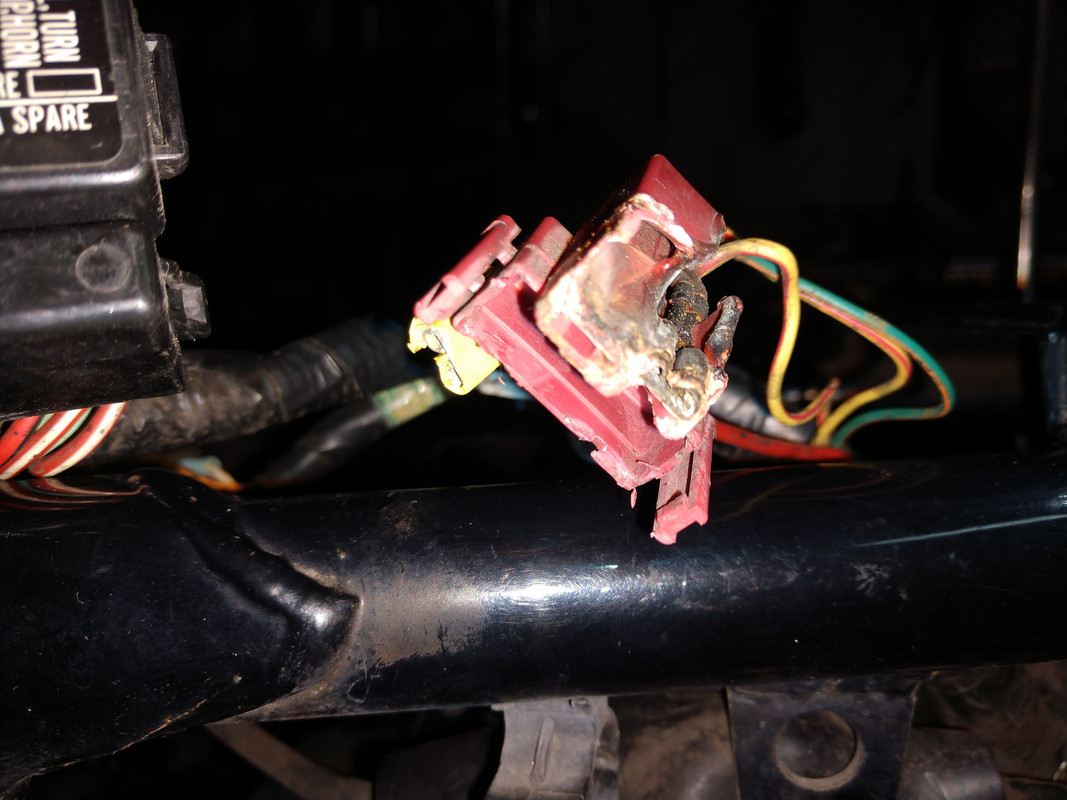

So back in October, I picked up a project 99 Interstate with 70000 miles on it.  It sat outside for a year and was in need of lots of TLC.  So after stopping him down and cleaning, polishing, and repairing plastic, I was trying to clean the accumulated crap off the wiring harness prior to beginning reassembly.  In the process I found the starter relay is toast, and may have discovered why.
Here's the relay.
Can you spot the issue in the second photo?
« Reply #1 on: January 04, 2020, 02:36:36 PM »
I'm not sure about the second photo, but maybe
someone replaced the main fuse with a wire?
If that is what we're seeing, look in there and see
if the "extra" fuse is still there  Smiley ...
« Reply #2 on: January 04, 2020, 02:54:59 PM »
That’s one way to fix a blown fuse  Shocked

Maybe he counted 55 copper strands and said good enough.
A really big fusible link.

Joe...looking at the 2nd picture, how did that wire wire not dry. It appears to be jumped between positive and negative. I know it is just jumping that fuse but the wiring color is confusing.
Posts: 8763
« Reply #15 on: January 15, 2020, 06:18:15 AM »
That wire was installed in place of the 55 amp dog bone fuse.  It is in line in the B+ lead to the starter relay and everything else downstream from the battery.  it goes + to +, not + to -.

Thanks, I got a replacement from my buddy Bill-Jr.
