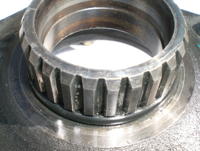

  Question is... How 'much' service should I do to the rear end on a 99 standard with 13k on the ODO.
The bike started it's life in Arizona...now in Mich. I'm changing the Metzler to an ATT and I'm hoping , barring any ominous appearances , to only do the Moly lube with O-rings,washer and a good clean up.
 Any real reason to go any further???

Pull, clean, and lube the drive shaft...may as well replace the oil as well, just make sure it is hypoid gear oil.

A good rule of thumb is to service the rear drive at every rear tire change. You used the term "Moly Lube". Please don't use Hondas paste. A good quality moly grease that's waterproof is much better.

Did you find an ATT for sale somewhere, or have one sitting on the shelf? Far as I knew they've been unobtanium for around a year now.
For a new-to-you bike, definitely recommend pulling the drive and inspecting/lubing the splines on the driveshaft and pinion cup. Ideally, the pinion cup will be sloppy wet with hypoid oil, that was Honda's design intent, but for whatever reason, they are bone dry seemingly more often than not, so once the grease dries up they wear rapidly. Clean any crud out of the pinion cup and ensure the two oil holes are clear, otherwise you'll definitely never get any gear oil up there. Lightly apply a good moly grease (the pastes dry out very quickly), not so much it'll squish out and plug the two oil holes in the cup.
The "rule of thumb" is to check/regrease every rear tire change, or 15k miles, whichever comes first. Personally I think that's a bit overkill, I checked mine after 15k and it looks like I had just regreased it yesterday, but I also live in a warm/dry area and very seldom ride in the rain. Or wash the bike. Lol. I'm currently at about 20k on my ATT and recently measured it at 5/32 center and 6/32 edges, I believe 10/32 was new, so guessing I'll get maybe another 10-12k out of it.
Meanwhile my buddy's Valk had never had the drive pulled until about 55k, and the pinion cup was soaked in gear oil and splines looked absolutely brand new. Why some drives circulate oil up to the cup and others don't is one of the great mysteries of the universe.
A kit with improved o-ring seals are available from Redeye. On 20+ year old bikes these are frequently found to be damaged or missing entirely, they're very easy to overlook at tire changes. This won't cause oil leaks, but if they are missing/bad, the grease on the wheel splines will dry out/wash away much faster.

If I'm not mistaken the 'pumpkin' is the final drive...the drive shaft will come out when you unbolt the unit from the housing.
And use the final drive flange from the tire to line up the drive shaft splines...

Don't forget to take a small stick or a Q-tip and make sure the small hole in the pinion cup is open so that the rear end  iol can get up to the splines on the drive shaft.   The seal between the rear end of the drive shaft and the pinion cup will almost certainly need to be replaced too after 21 years.    They turn rock hard with age  (if only- lotta jokes there)

It won't hurt anything.  That seal is more of a dust and dirt guard, than a seal.  I've only replaced one in the dozens of times I've had a drive shaft out.
As far as doing the service goes, it's a good rule of thumb to do it every 10K or tire swap.
But, before it became the current way of thought, I put 80K on my original Valk before I understood why I should.
When I did the first, everything looked like new.

the seal i'm talking about is the one on the driveshaft at the pinion cup.   Both times they failed, got hard, cracked and came apart,  the splines wore out right after that, in my case.  Those seals are what keeps the lube in the splines.

Getting ready to replace my back tire (bought a 205/60 Yokohama Avid Envigor, my first DS), and looking for all the info about doing the final drive maintenance (my first stab at that as well).
1] I get "content isn't available right now" when I click  BigBF's facebook link above. ??
2] Also can someone provide a link to "Dag's" video?  I have not been able to find it, but have seen references to it.
3] I bought Loctite LB 8012 Moly Paste (65%).  I'm a little uncertain as to exactly where to use this, vs where to use regular grease (I have Valvoline 70133 Cerulean Multi-Purpose Grease).
I bought the 3 o-rings from Redeye, and a new thrust washer if needed.
Advice appreciated, as always!

As to where to apply moly paste, I just found some of the older threads about that, and now realize why ChrisJ's write-up strays a little from the service manual.
Also found a great 5-part write-up in valkyrieworld by Wood Butcher.

Has anyone mentioned the torque sequence?  That is BY FAR the most important thing when putting it all back together!  When reinstalling the rear wheel you MUST tighten the axle nut BEFORE tightening the 4 nuts that hold the driveshaft tube to the final drive.  That aligns the drive spines between the wheel and final drive.  If you tighten the 4 nuts first, there's enough play in the 4 holes that the drive splines may mesh at an angle, which will force the splines to grind constantly, sort of like a U-joint.  Then it doesn't matter what grease you use there, the splines will quickly wear down.
The grease for the drive splines isn't that critical.  For well over 100,000 miles I used a can of wheel bearing grease I bought over 30 years ago.  As the photo below shows they still looked great at around 140,000 miles.  As for the driveshaft I've used Honda's moly paste at the U-joint in front.  For the pinon joint end I started following the advice from the service manager at a pretty good Honda shop.  He said he'd seen too many cases of the oil hole in the pinon cup clogging, so he just packs the cup with as much grease as possible, and makes sure the oil seal is good.  I've heard of others using his method, and so far I've had good luck with it.  The pinon may be the weakest link in the driveline and is worth some extra attention.
