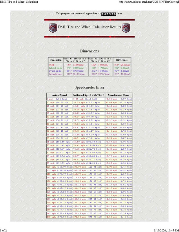

. . . . I ran a rear Michelin Pilot 130/90r17 upfront . . . . Being a smaller, narrower tire the speedo was way off . . . .
According to a tire calculator, the difference in the speedometer reading is less than 1 MPH until 110 MPH. I did not notice a difference between stock and my 130/90R17 or my MT90HB17 (which I believe is the same as 130/90R17).
YMMV

I'm a bit curious why nobody ever seems to try a 195/60R16 DS tire...
That has me curious as well. It may be that my method choosing alternate sizes doesn't include the 195's. I use https://tiresize.com/calculator/, punch in the OEM size, and browse the "Alternate Sizes".
I concur a 195 series tire being more narrow, would handle a bit better.
