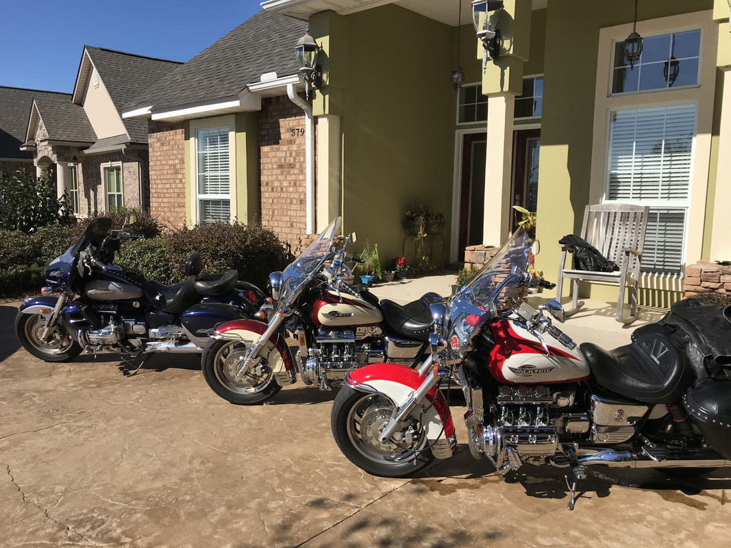

  Roll Eyes  What the heck.....  ???   So now I know right.  I want to Thank my good friend Jeff for educating me about my Buzz-bolt.  Cheesy Had know idea that I had one, do you know you have one ???
 Thank you Jeff for helping me recognize that unfamiliar noise coming from my Super Valk. That dang Buzz Bolt sure was the issue and now it's Fixed.  smitten
 In front of the house were these 3 dragons while my Super Valk was still undressed alittle.  coolsmiley
Cousin John's IS, Renegade and Jeff's spotless Cobra.  Evil
