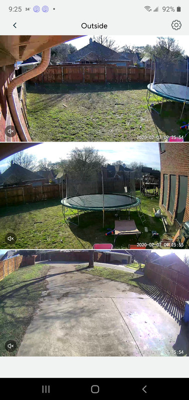

I'm cheap and I like to tinker. I've got Wyze cams set up all around the house.
They're cheap.
$25ish each, $35ish for the PTZ version.
Simple. You can put SD cards in them for more storage, limited cloud storage is included for free.
They do two way audio, great picture/video quality. They can be set up to alert you via different mechanisms for sounds, alarms, motions in specific zones, etc.
They're not natively weatherproof, but you can get relatively inexpensive weatherproof enclosures.
They use WiFi, so you'll need to have WiFi coverage in the area of the cameras. They require a single USB cord for power.
Cons:
Not an active monitoring solution beyond the basics.
No computer/web browser way to monitor the cameras (Yet!), it's phone/tablet only (Although there are some work arounds if you really wanna get the cameras running on your computer, I keep a view of my front door up at all times on my laptop.)
Just an option to consider if you like to tinker.....
Example view of one grouping of my cams right now:
