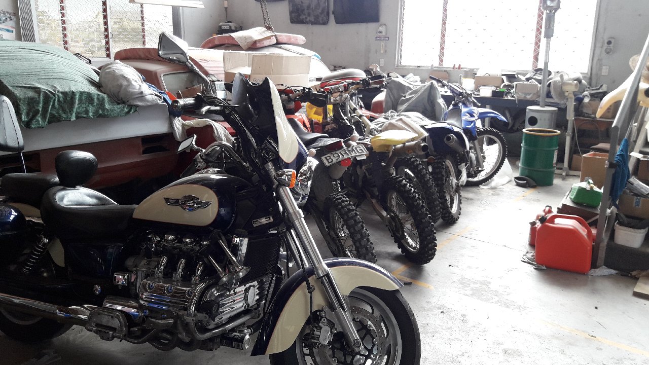

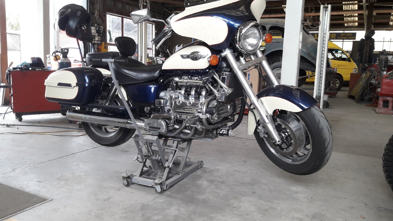

It seams every bike I own needs work atm, I took a few pics of some of the work so thought I would share........... Just because
Still more to sort yet, more bikes is not always more fun

XR250 (1986)

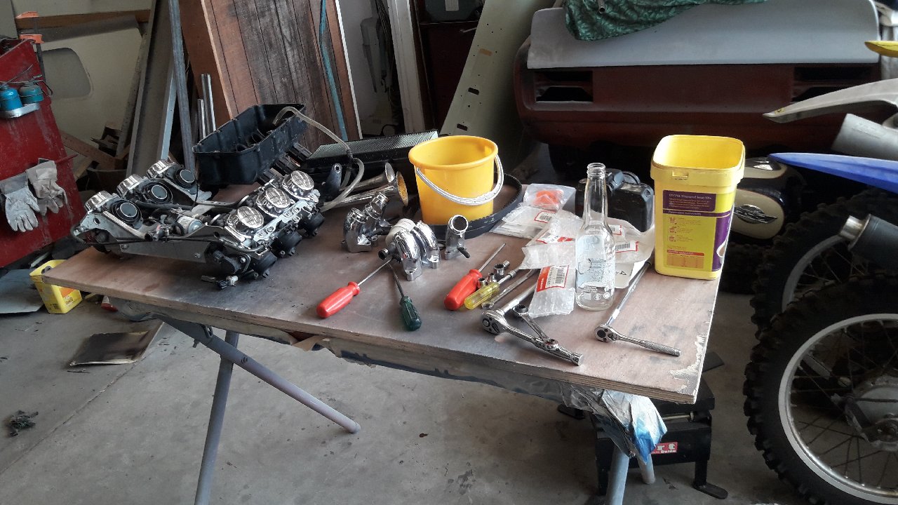

Rebuild carb, replace and strip n clean front brake master and caliper (didn't replace the seals...tried to keep costs down)  Ready for some use on the old girl
TTR230 Rebuild carb, bleed brakes and free up brakes, needs a caliper strip but has seized pad pins..... needs more work to get 100%

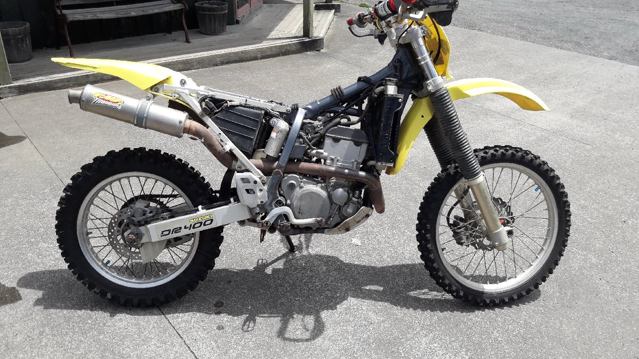

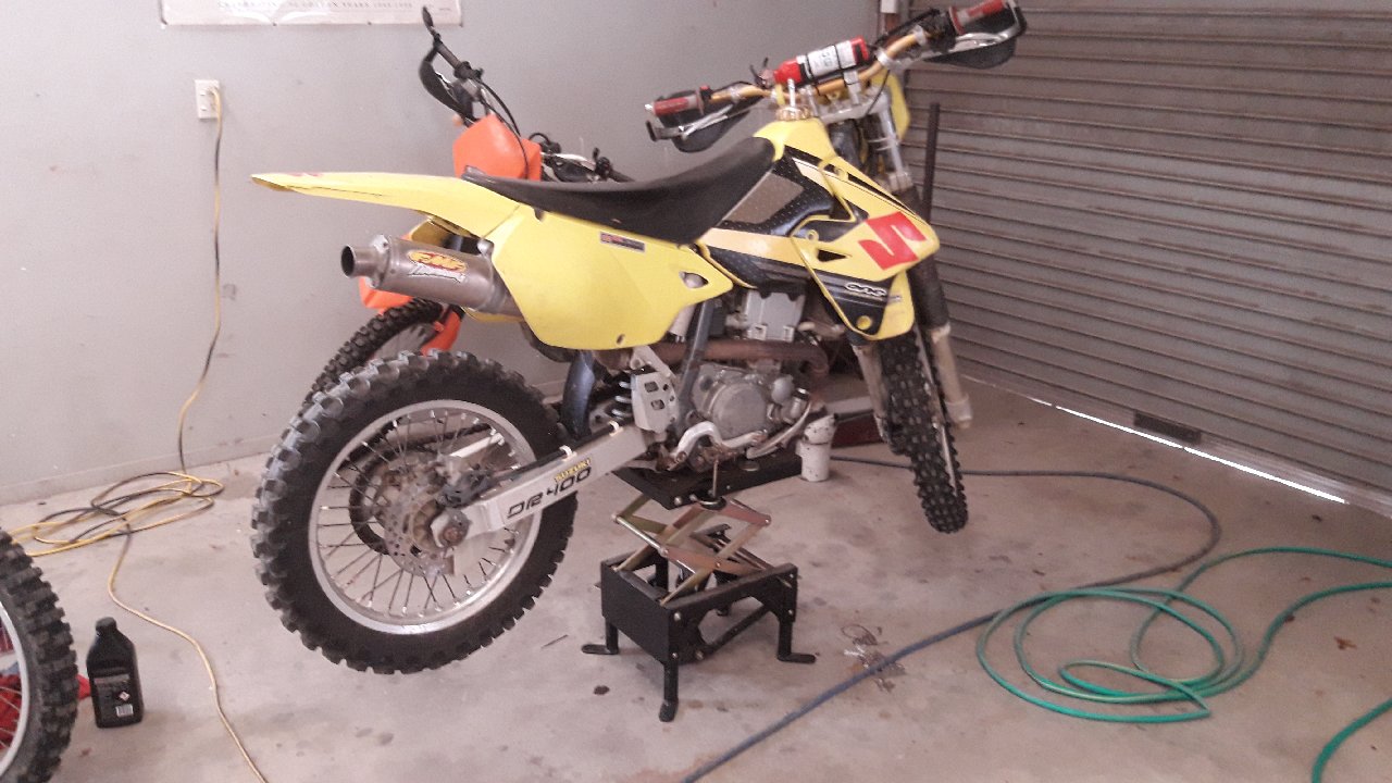

DRZ400 Strip calipers and clean to free up the pistons, Rebuild card (Major PITA to remove it) service the rest ready to sell....... If my son doesn't want it
VL1500 (Friends bike that Jim used) drain carbs, charge battery give it a run, easy job Cheesy

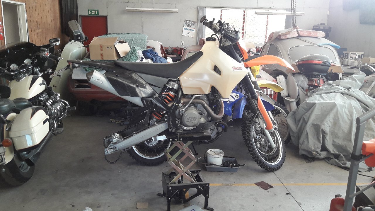

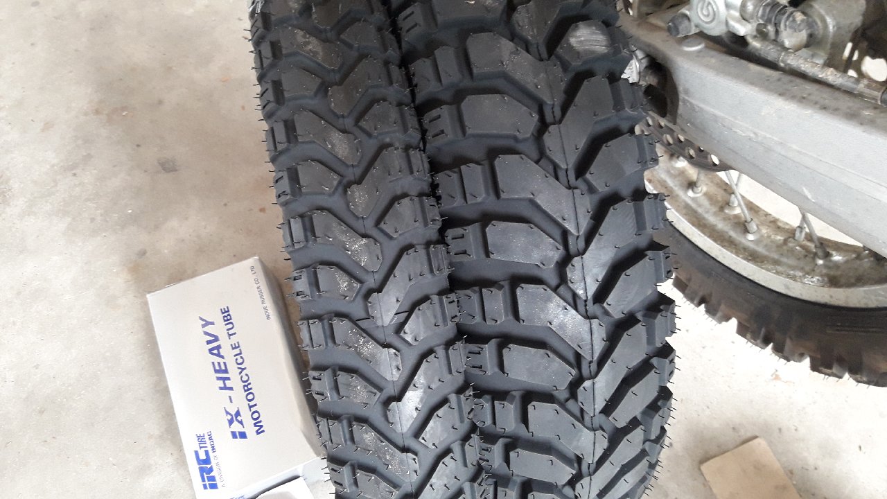

KTM525  Replace the steering lock (had no key for it) Fit an ignition switch (out of sight) Straiten and weld the crack in the front rim, fit some tires & new tubes (very stiff sidewall so Fn tight to fit)

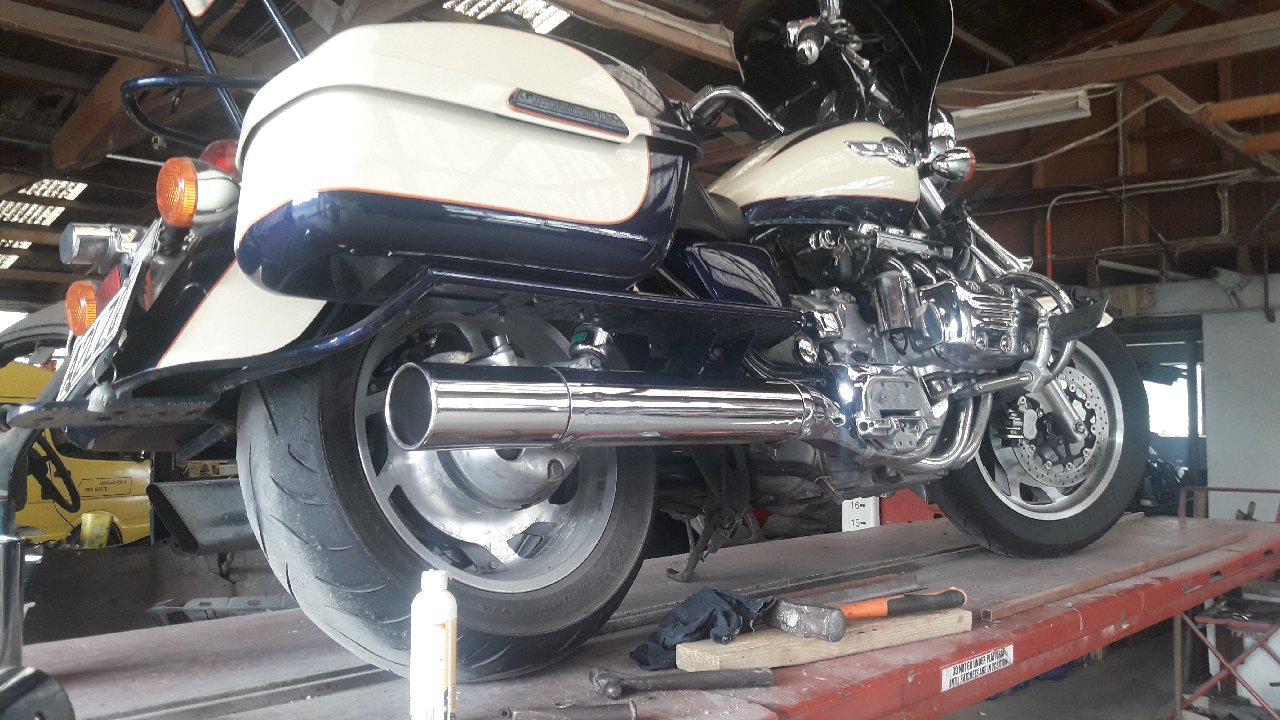

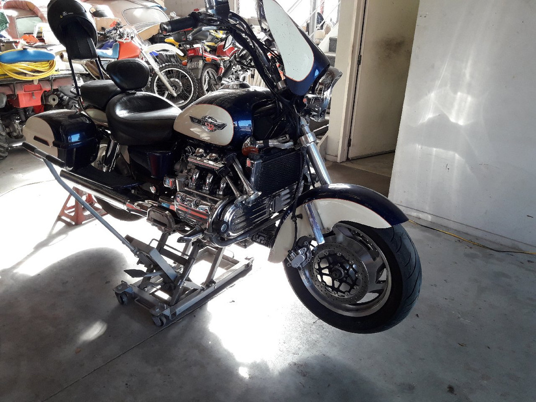

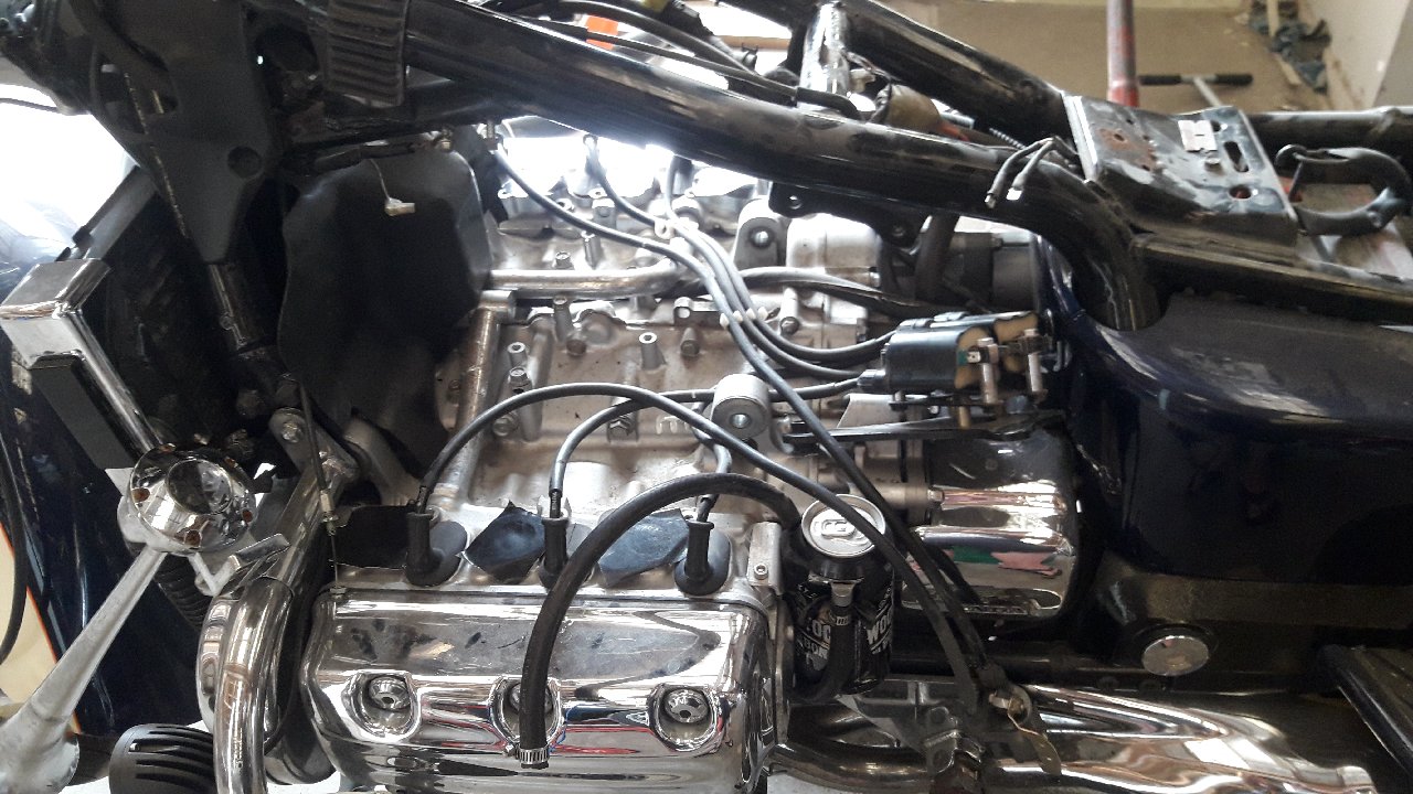

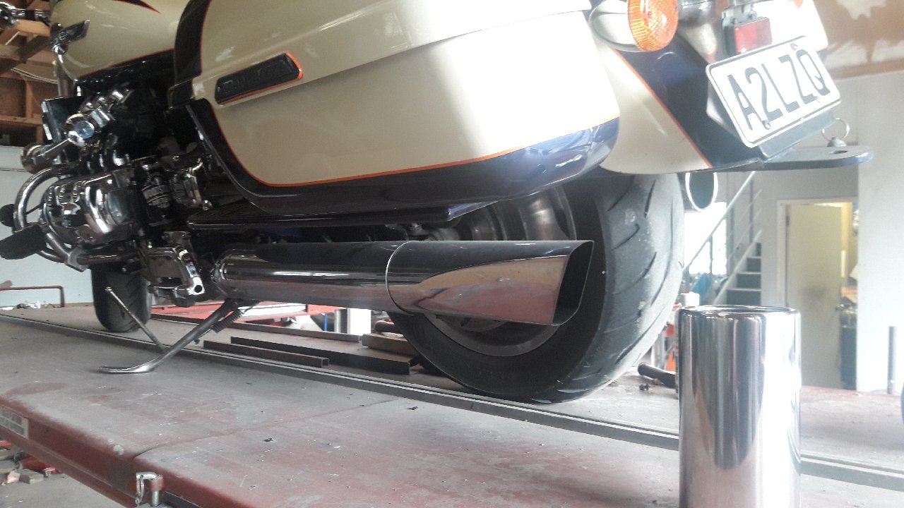

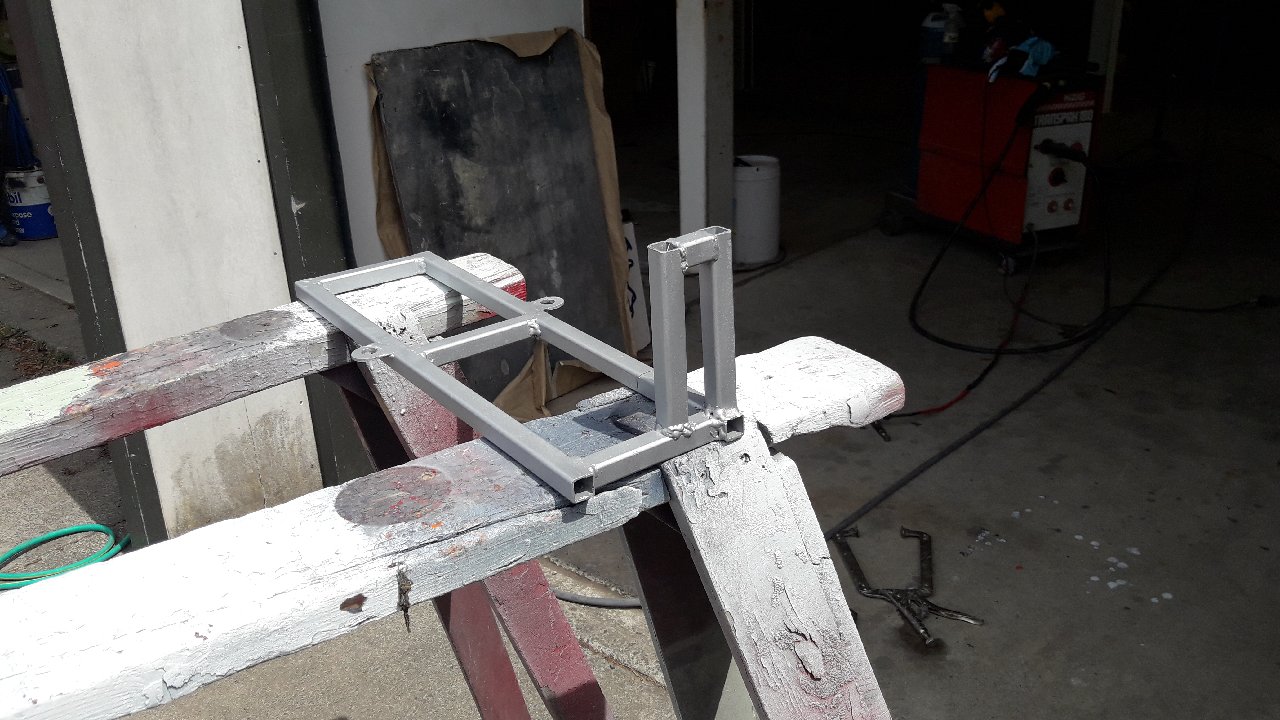

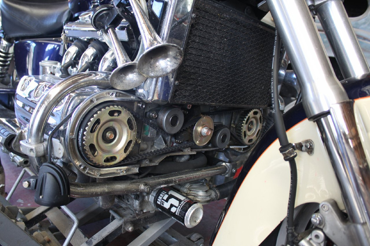

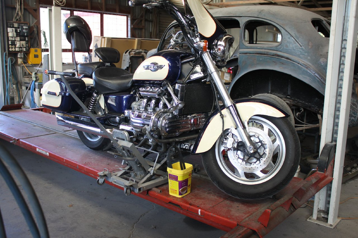

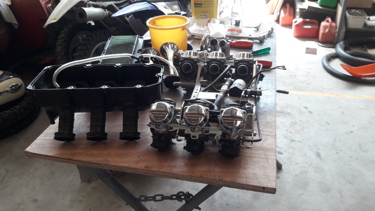

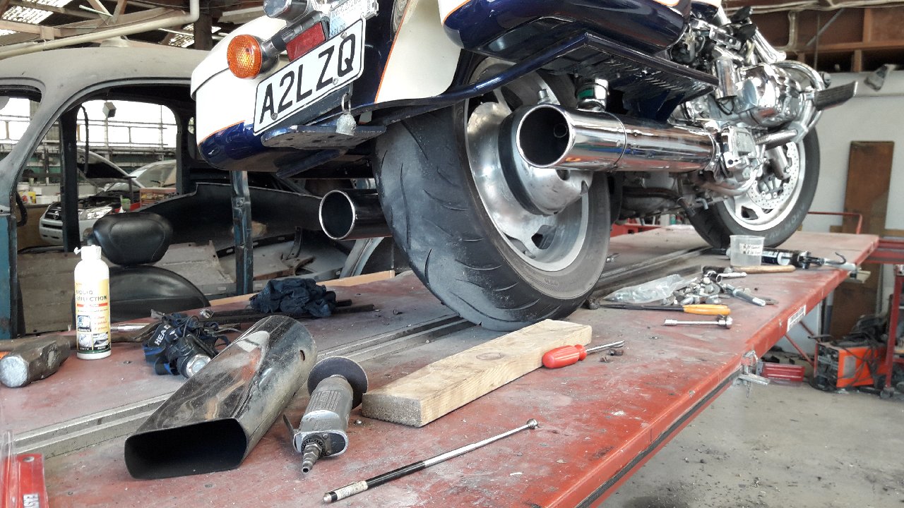

Valk Remove carbs and fit new floats, fit new mix screw kit (mine had a couple of washers missing when I got it) clean coil mounts (a little rusty) replace cam belts, replace fan switch, Make jack frame, secure exhaust shield and mod/fit exhaust tips
 Still going to teak the forks (lighter oil, too stiff) Make forward controls, make trailer, replace shocks, mod seat (old and foam is hard) and so many more things I can't remember atm

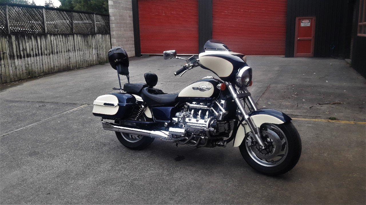

« Reply #6 on: February 09, 2020, 10:24:08 AM »
I got out for a ride yesterday and was pleasantly surprised how the new tips have changed the exhaust note, it's now a deeper growl down in the low revs and under acceleration but much quieter at cruise speed, doesn't drone like it did (pig tails removed and baffles punched)
 The shorter open tips made so much more difference than I expected

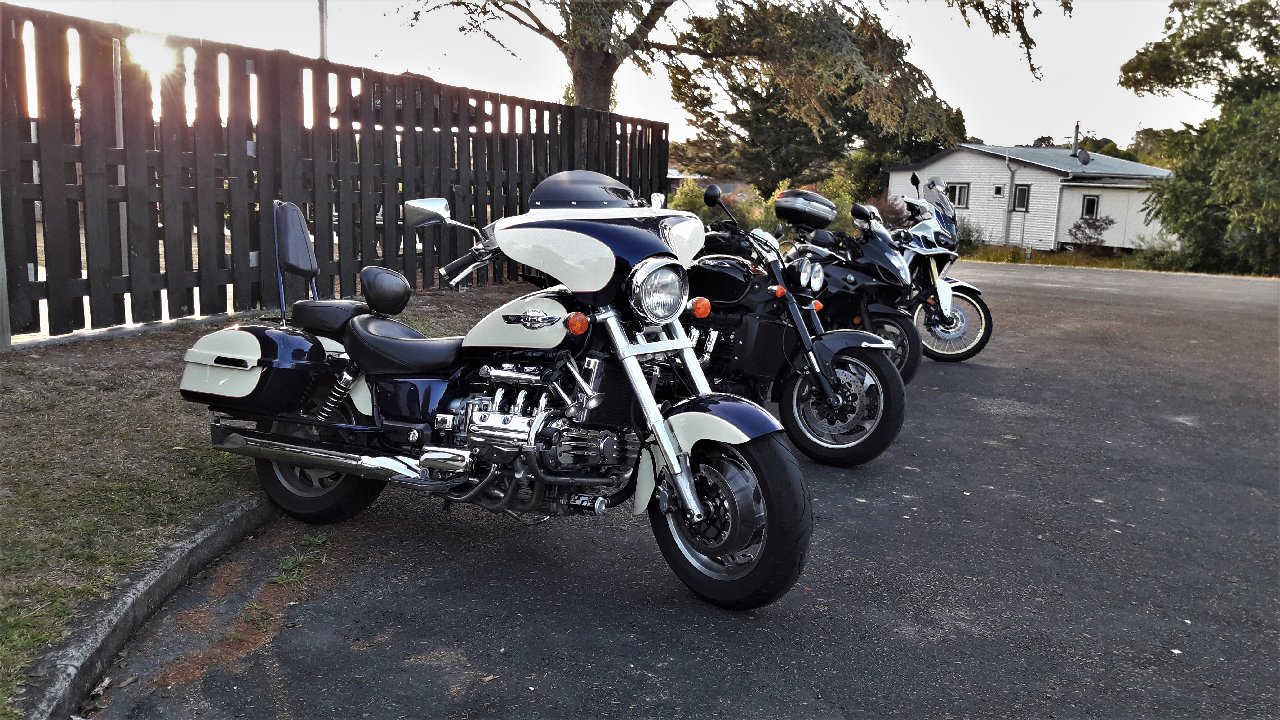

A few pics from Yesterdays ride

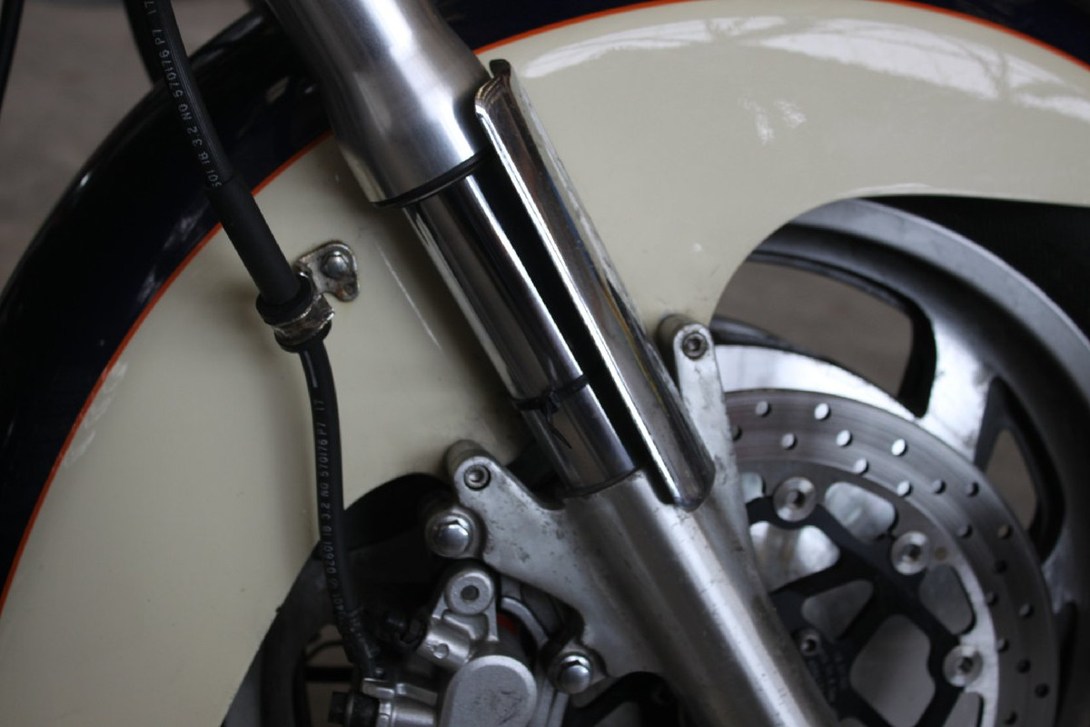

After fitting the Progressive fork springs the front awhile back it has been too stiff for my liking with 10W oil so I got some 5W oil
 Had a look and figured slipping the RF fork out was easy enough so tipped the oil out, measured the volume and replaced with the same volume of 5W and back together in record time Cheesy
 A quick test ride and it's not too soft, Will go for a long ride tonight and see if I like it   laugh

Rather than going with a thinner oil weight, many (me too) went with a couple ounces less of the called for 10 wt.  Syringe it out without full disassembly?  Whether done by oil volume measure, or measuring from from the top.
I paid rather large money to get my forks rebuilt and Progressive springs added a long time ago.  And the front end might as well have been a hard tail..... shoulder jarring, teeth rattling.
The guy (at a metric dealer) had a long history of working on Wings, and swore he did the job entirely by the book (with 10wt), so he expected to be paid again to go back in.  I wouldn't pay, so I lived with them as is, and in a couple years they got more reasonable in stiffness.
I have also read multiple times that all MC fork oil is not the same; 10wt to 10wt, or 5wt to 5wt.  No clear uniformity among manufacturers of fork oils apparently.

 dropping the level will be stage 2 if required, I have a wire tie wrapped around the fork to check its travel while on the ride, I am about to head out on some rough roads... time will tell, I set the levels to spec previously. If the forks stop too short of bottoming I will lower the level and try again, but I don't want to go too low, need the oil/air to cushion it when it runs out of travel
 With my daughters bike the oil level was set too high when we got it so it bottomed early on the oil, made for a stiff ride

The LH fork has no damping rod in it, no valving at all, just has oil to lube and create the air cushion over the level the oil is set at so weight of the oil makes no difference

The wire tie shows I still have 40mm of travel with normal riding on undulating rough roads, I also tried some heavy braking over bumps and that took it down to 30mm travel left....It was a nicer ride but I may drop the level on both a little and try again when I get a moment
